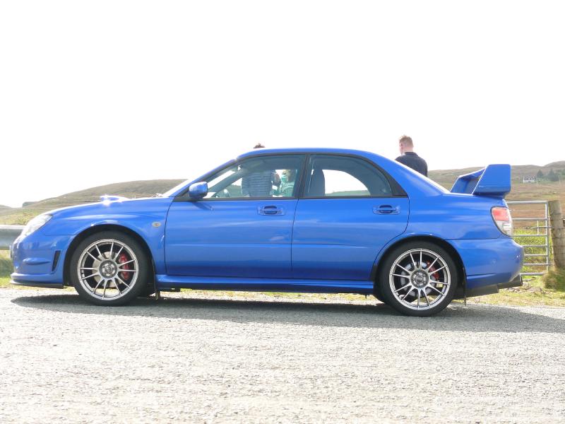

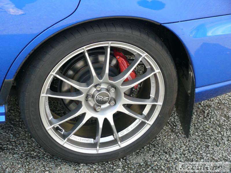

RA Dunk Posted January 23, 2010 Posted January 23, 2010 . o O (*drool* at the thought of Oz Ultraleggeras... ) You mean like mine Soz couldent help a wee rub in.
scouk Posted January 23, 2010 Posted January 23, 2010 You mean like mine Soz couldent help a wee rub in. More drool.... They suit pretty much any car... A lthough Woudl need to be 18's and Ultraleggeras not superleggeras..I prefer the look of the ultra's (not much in it), slightly sharper design.. Shame the bank balance doesn't like them as much

BalliSTIc Posted January 23, 2010 Posted January 23, 2010 (edited) You mean like mine Soz couldent help a wee rub in. *chortle* On the subject on "one-up-manship", sir, those are clearly SUPERleggeras unless you've been hard at the photoshop! *lol* Bit of fun & no flames intended... OZs ROCK!!! ...And I can't resist EITHER... *lol* Edited January 23, 2010 by BalliSTIc
scouk Posted January 23, 2010 Posted January 23, 2010 *chortle* On the subject on "one-up-manship", sir, those are clearly SUPERleggeras unless you've been hard at the photoshop! *lol*Bit of fun & no flames intended... OZs ROCK!!! Good point.. didn't mean it to sound like a flame... But since this is turning into an Oz porn thread: (not my car.. just got excited by the wheels... )
