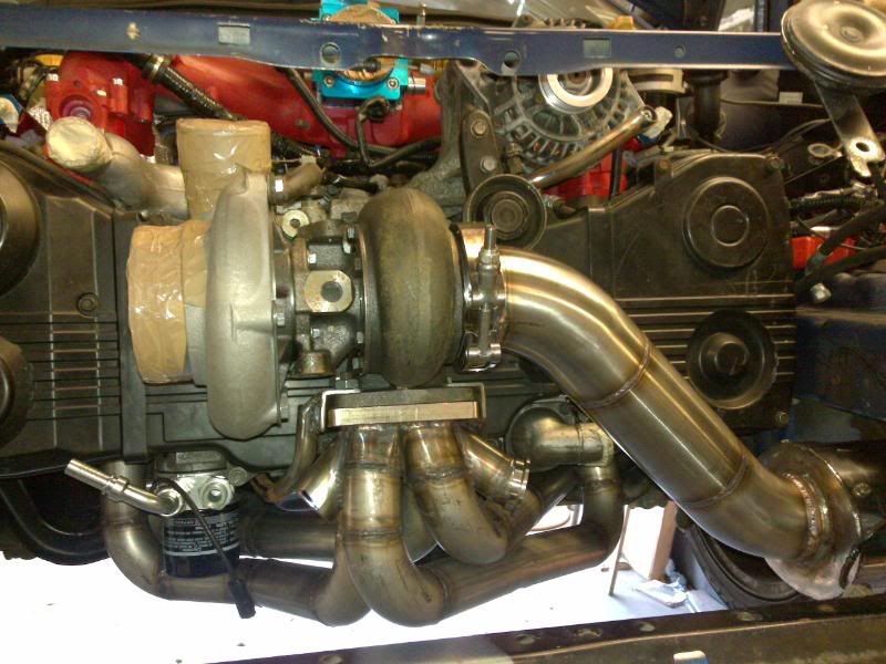

mctwistuk Posted March 22, 2013 Posted March 22, 2013 Turbo? What did you think i was going to ask lol. Over the years i have always enjoyed seeing peoples build threads and turbos seemed to get bigger and bigger and bigger. So now it is time to see who really has the biggest. Let us see pics of your turbos to see who really has the biggest Chris
