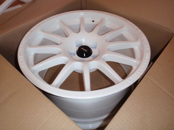

TrackScotland Posted August 7, 2010 Posted August 7, 2010 (edited) Updates... New engine is in - mapped - run in - oil changed. Its just getting some finishing bits and bobs done to wiring for MSA Blue book regs. It SHOULD be out on track on the 16th IF the spare wheels (gold) fot over the calipers. New wheels arrived today - but dont have the arch mods done to accomodate them yet LOL 9" wide on a classic 2dr. how the car was looking.... front splitter setup is slighty different now. Be good to get it back out on track and hopefully used in Nippon and SMRC Sports & Saloons before the end of the year Edited August 7, 2010 by TrackScotland

TrackScotland Posted August 17, 2010 Posted August 17, 2010 a pic showing its lovely gold wheels LOL mmm mmm (Simons old ones finally making it onto the car as a stop gap till the widearches are done) Fee needed to fit a 5mm shim to clear the struts on the rears - high offset wheels, about 2deg camber. The Advans dont clear the front brakes so they'll be up for sale soon. also looks like a fair amount of weight transfer (to the rear under acel) going on in the pic... no idea what she had the susp set up as, or even if the ride heights are quite right LOL

TrackScotland Posted August 31, 2010 Posted August 31, 2010 washed the car, fitted the XP10 pads and went on the look for some more castor First up was flipping the mount for the alloy lower arms (to the ALK) 180deg. The mount is offset so this pushes out on th rear of the arm and forward a touch. Secondly I made sure the ALK's were mounted as far forward in there slots as possible. Its visably added more castor, and given some toe in that will need sorted crappy pics... but this is the mount I flipped before after clean'ish longer wheel studs and some hubcentric spacers arrived I'm being optimistic and thinking I can space them out 16mm more 5mm shims allround in pics above, could have gone with an ET15 or 9.5" rim but wouldnt have got these wheels in those sizes see what happens
