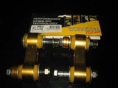

scouk Posted September 7, 2008 Posted September 7, 2008 These front drop links are more hassle than they are worth TBH... Not for fitting but because of the dodgy advice going around.. When I researched it a few months ago I got completely confussed.. But here's the facts: Whiteline KLC30 = Used with WRX Steel wishbones to replace "plastic" drop links Whiteline KLC32 = Used with WRX alloy wishbones and STi's to replace the "ball joint" drop links Due to the confusion and the shortage of whiteline parts in teh UK at the time I opted for Perrin drop links which have a fancy bearing on them isntead of a ball joint.. But... I think Scooby-Girl had problems with the perrin ones not longer after fitting them and I get a creaking noise form the from of the car since fitting them.. to be honest if I was going to replace them again in the future I'd just buy the steel OEM ones.. Hugely cheaper and they are still made of strong stuff (not plastic).. So the difference between OEM and these "perfomance" ones is probably none.. Unless you replace the ARB's as well. YOur not the only one with the wrong type of drop links.. I have seen loads of cars now both in the real world and online uing the KLC30's on the wrong type of car after being reccomended them.... They still work.. But they don't line up properly and hte bushes will burst prematurely due to the excess pressure on them...

scouk Posted September 7, 2008 Posted September 7, 2008 Here's a pic of the KLC32's Thing is due to the design.. Both the Bearing and Polyboosh versions will wear out.. But With the added pressure/twist on the whiteline ones, they are more likely to wear out quicker.. Whereas the bearing ones "should" last longer if they are kept sealed and don't get dirt caught in them..

fiestajohn Posted September 7, 2008 Posted September 7, 2008 They do seem to do the right ones (KLC32) for your car according to the Whiteline website (and if Duncan at Hypertech says so that is good enough for me) I would have another go at fitting them with the weight of the car on its wheels if I were you though, to see if they sit any better.

cusco kid Posted September 7, 2008 Posted September 7, 2008 This is the drivers side; tommo thats the wrong type m8 they are for metal lower arms you need klc 39 bud geo
