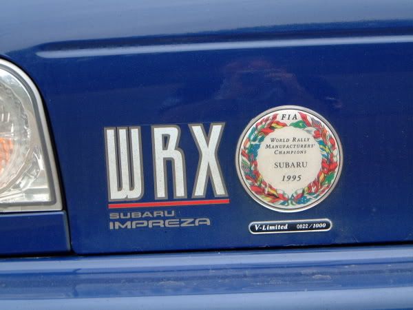

Wee Jock Posted January 7, 2011 Posted January 7, 2011 Alright. Sorry about that, i thought the link was to the car. Its actually the dark blue N reg, 5th car down on page two and the white N reg below it. I like the white one the best but dont believe its a V-limited and im also a bit dubious weather its an STI since the mirrors and skirts aint painted. Cheers Hyper The year is wrong for the white car it says 1998 should be 1996! I had a WRX V-Ltd of that year there are pictures on here of the car somewhere, see my avitar! The V-ltds of that year had a WRC Winners badge on the boot and embosed into the seats(so the seats are wrong), also had the Cars ltd no on the boot as well, mines was .......... Im not 100% sure but I think there were 500 white & 500 mica blue!
Wee Jock Posted January 7, 2011 Posted January 7, 2011 (edited) Heres a link which tells you the model of the car and the engine type, check this against the vin plate of the V-Ltd, should be: Applied model-GC8C48D (For it to be an STi the last 8 in this number would in fact have to be an E,an RA it would be 7) Engine Type-EJ20G DW5HE The car also came with a Z4 ecu which was equivalent to a Prodeive PPP and the car was actually 270bhp! http://www.catherineandken.co.uk/sti/wrx.html Edited January 7, 2011 by Wee Jock

Wee Jock Posted January 7, 2011 Posted January 7, 2011 The white one is no V-LTD STi as there were none made for that year! Only V-Ltd WRX like mine, which started production in 1995 and ended in 1995. It has no V-Ltd seats, badges or Ltd car number. I wouldnt personally trust someone who has a disclaimer stating : Every effort has been made to ensure the accuracy of the above information but errors may occur. Please check with a salesperson. Pays to do your research before you advertise. In my opinion I doubt it is what they say it is and I wouldnt touch it with a bardge pole!
