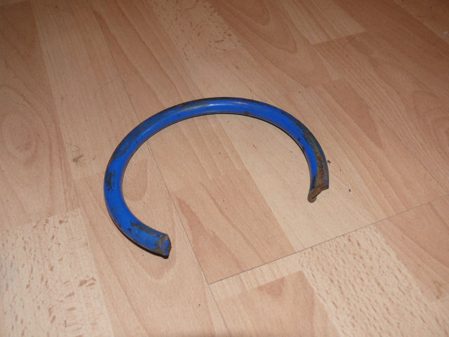

scouk Posted November 8, 2008 Posted November 8, 2008 (edited) Just how soft is subaru /prodrive suspension!!! I replaced the rear dampers on my car with KYB shocks last year along with a full brand new set of prodrive springs all round!! Discovered a couple week ago that one of the rear shocks appeared to be leaking!! (I've heard the stories of chocolate dampers on here) so was looking into upgrading to prodrive /Bilstein shocks to replace them next year.. But... After going over the car today (just started, gawd knows what else I'll find) It appears I have a very broken prodrive spring on the front offside!! The bottom loop of the spring has broken off!! The damn things are under 18 months old!! Now I know the car has felt a bit wonky recently but bleedin ell!! How can the Impreza suspension be so soft and brittle with road driving! Not a happy chappy at the mo..... Edited November 8, 2008 by ScoUK
Spaceman Posted November 8, 2008 Posted November 8, 2008 cntact prodrive see if they will do a good will for you greig guess the car will have not done many miles on them Greig
nkwrx Posted November 8, 2008 Posted November 8, 2008 (edited) Jeez oh mate that's an outrage! As you say chocolate shocks etc but a prodrive spring...WTF??? Edited November 8, 2008 by NKWRX
euan_r Posted November 8, 2008 Posted November 8, 2008 (edited) its the ****ing state of the roads. ive done the same a few months back alan. lowering springs on standard shocks will lower their life expectancy too, surprised at only a year though. you didnt grip the damper with anything while tightening top nut i hope. edit: also a good idea to fit coil wrap to bottom one/two coils on spring when fitting as it stops strut cup scrapping off paint on spring. Edited November 8, 2008 by euan_r
cullenmin Posted November 8, 2008 Posted November 8, 2008 Got to agree there, lowering springs on standard dampers won't last as long as expected, especially on some of our roads. Best get saving for the prodrive/bilsten setup Al
scouk Posted November 8, 2008 Author Posted November 8, 2008 (edited) Well it's a case of out with the new and in with the old! Handling will be even more shafted than normal now as well.. edit: also a good idea to fit coil wrap to bottom one/two coils on spring when fitting as it stops strut cup scrapping off paint on spring. Good point! Must remember that when getting it back together again.. Got to agree there, lowering springs on standard dampers won't last as long as expected, especially on some of our roads.Best get saving for the prodrive/bilsten setup Al Yeah expected the shocks to wear out a little quicker due to stiffer prings but just over a year is silly also the fronts still appear to be OEM shocks yet replaced the rears last year and it's one of those that appeared to be leaking again (and care was taken when fitting ).. certainly shouldn't be seeing broken springs after just over a year! (about 14k miles or thereabouts.. I think) Yep, full prodrive package is definately on the cards... Just dunno when now..... *sigh* Edited November 8, 2008 by ScoUK
scooby222 Posted November 8, 2008 Posted November 8, 2008 thats shocking Al,ive had prodrive springs on mine for about 15k now and theyre fine and its safe to say im considerably more aggressive in my style than you! as for the dampers well... heard today about a gb270 with under 2k miles and on its 3rd set of shocks!!! having had a proper run todat on my new setup im delighted with them,best money ive spent on the car. first time ive been truly happy with the suspension in 2 years,so next time im down or your up should meet up so you can see what yo think- in VFM terms i think its very hard to beat. as an aside nice to hear today that whiteline uk distribution is back in safe hands,pleasure to bump into Job at awd.
scouk Posted November 8, 2008 Author Posted November 8, 2008 thats shocking Al ive had prodrive springs on mine for about 15k now and theyre fine and its safe to say im considerably more aggressive in my style than you! as for the dampers well... heard today about a gb270 with under 2k miles and on its 3rd set of shocks!!! Yeah I've heard the hawkeyes are particularly worse again for the shocks than the bugs/blobs Always seems to be the rear end ones... Never heard of any problems with the Prodrive springs though.. If I can't get the spring replaced easily and am effectively forced to buy a whole new spring kit, I may look into the same coilover you got.. But would prefer to stick to the Prodrive theme Asssuming they don't break again.. Other 3 springs look fine.. Possibly just a flaw... (which could have been V dangerous!) I'll get in touch with T&C on monday and see if they will do a good will gesture, otherwise will try banging on PD's door.. You never know... More chance of getting somewhere there than Moray COuncil/BEAR scotland It's a right bugger!, got 2 weeks off work just now and had great plans for the car, got a few new goodies to fit and had just started to get all the crap cleared out from every nook and cranny then sealed before the salt roads really kick in, only to discover the spring looked a bit dodgy.. BTW - Don't suppose you remember where you were seeing that Bilstein Dampers for sale that you mentioned last week?

Gee Wr1 Posted November 9, 2008 Posted November 9, 2008 It's probably due to the state of the roads we have up here Go find the biggest pothole you can see, take photos of it, contact the council & blame the pothole for the damage to your spring & make a claim It's worth a try lol. I'm only on 2nd set of rear shocks on the wr1 in 4 1/2 years so i seem to have been quite lucky.
scouk Posted November 9, 2008 Author Posted November 9, 2008 Go find the biggest pothole you can see, take photos of it, contact the council & blame the pothole for the damage to your spring & make a claim Not a bad idea... Was having a look around today for one Excuse my ignorance, but what is the faciniation with Tein suspension... OK everywhere seems to sell it and quite a few peopel have them,. but there's also comments that they are very low and very hard ride.. But in the real world are they reliable...? Anyone manged to break a set yet? Kinda the prioroty at the mo.. At the moment I'd have nightmares of having to replace coilover kits annually... Looks like annual rear shock change is standard these days...
