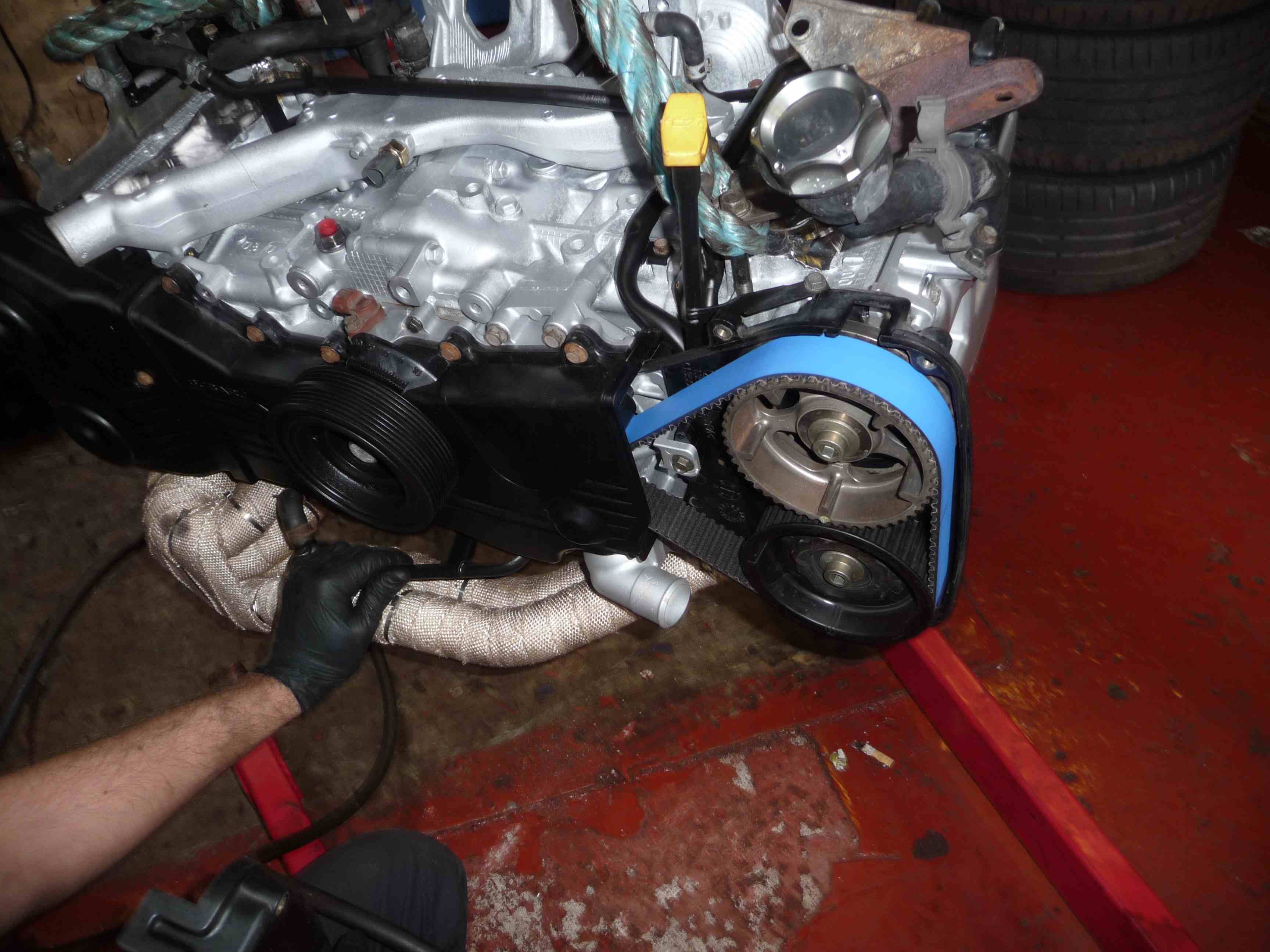

No its still a 5 speed box that have, the only thing is looking through were the other starter bolt goes it misses the flange so could just be tapped, thats why i put it into Agra, Its a strange one like!! I have a question for you Arch, i am just away to do all the fuel lines and i am putting a t-piece on either side of the fuel rails so that there are only 2 connections to my FPR.....so from the fuel line to the filter.....filter to the t-piece which then feeds the rails....then teed up again.....then to the FPR (right hand side of the FPR keeping the piping away from the turbo).....then from the bottom of the FPR back to tank!! but when looking in the corner under the bonnet it looks like there are three fuel lines!! what is the other line for?? Cheers Jase
Yeh its the right one.....its not just the starter....in total i need 4 modified!!
I would do it if i was u!! You dont need to fit the flywheel and clutch as there are dowl pins between the engine and gearbox so it will be lined up and then you will see if it matches.....one of the ones that doesnt for me is for the starter so you need to check that one!!
Yeh i stripped the engine and gearbox out this afternoon and im taking both up to them in the back of Jcscoobs van tomorrow
They are going to butt up the engine and gearbox and check all then add flanges were required along with drilling and tapping new holes!! they are engine builders in Dundee and are really good and buy the sounds of it they are going to get it done quite quickly for me...so thats a bonus Yeh the S206 looks good like.....he says the mid range on it is better than the GT35

Well got my engine today looks great!! Fitted my exhaust,turbo, sensors etc then got the flywheel and clutch fitted ready for mounting in the car Then when i butted up the engine to the gearbox i found only 4 of the bolts line up........one of them being the started bolt which i couldnt even do anything with as it misses the flange on the engine!! So phoned up Agra and now stripped the engine back out along with the gearbox to take up to them so they can do what needs to be done to make it all right!!! aaaahhhhhrrrggggg!! So now the car looks like this Oh well thats the joys of moddin i suppose!!
