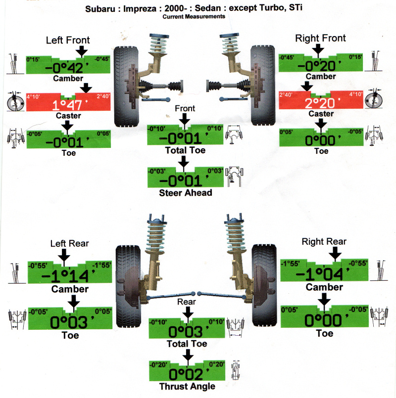

scouk Posted May 29, 2008 Author Posted May 29, 2008 (edited) hi i know this tred was over ayear ago. YOur not kiddin! where'd you find this one! Here's what mine were set-up for.. They didn't actually change anything it was already set like this.. Not bad after changing the springs myself FYI - the proper Prodrive setting are much the same but with a LOT more camber on the front about 1.1-1.2 IIRC But they are knows to eat tyres.. Most reccomended settings seems to be around the 0.5 range which makes sense.. Edited May 29, 2008 by ScoUK

scooby doom Posted May 30, 2008 Posted May 30, 2008 Having recently had new KYB gas shocks fitted all round with Whiteline Flatout springs and a Whiteline solid drop link kit I took the scoob off to GT Tyres at Forres and here's the result Wasn't sure this would all be worth it but I certainly notice the difference

scouk Posted May 30, 2008 Author Posted May 30, 2008 am guessin no matter what no car is goin 2 have the same setup. evan tho all 3 r bugeyes. Youll always get slight differences... Some bits cant be adjuted without remounting the suspension.. Small changes of 0.01 e.t.c are neglegable but the front camber settings where where the grip/tyre wear comes from. Some peopel set theirs up differently to the way they want it.. I'd like mine to be both closer to -0.4 but not worth the cost to get it done form what I have it set at already.. Standard is aroudn -0.2 camber at hte front.. Prodrive settings are -1.2 and the "Fast Road" settings you hear about are aroudn -0.5 If dave (Scooby222) was to post his up you'll see an example of how bad the settings can get.. His were WAY off before he got it done..

cullenmin Posted June 13, 2008 Posted June 13, 2008 After reading this thread I decided to go to GT Tyres in Forres to get my alignment done. I am very happy with the results...and quite surprised at the initial readings. As a few of you know I managed to buckle an alloy the other week at the fife meet so I knew the alignment had been knocked out a little. So anyway as you can see the wheel that got hit was all in the green and the rest were here and there. All straight now. Very impressed with the guy Paul who updated me on the progress of the alignment at each step and also showed a general interest in the car and its modifications etc. Thank You GT tyres in Forres. I would happily recommend them to anyone. Rich
