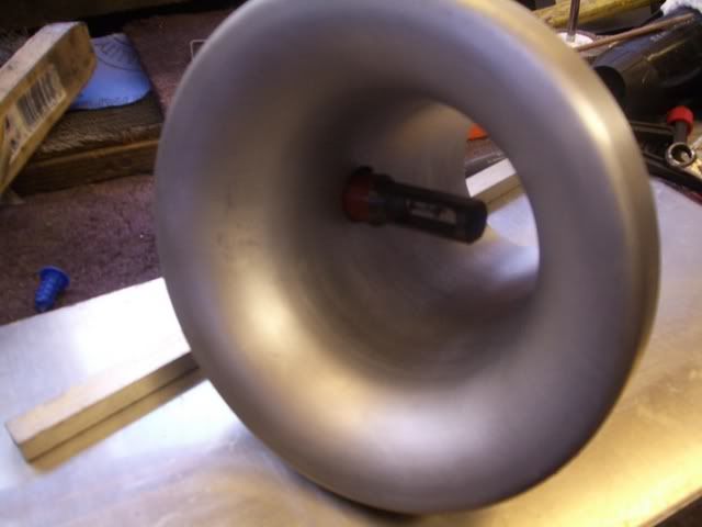

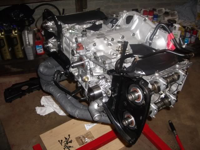

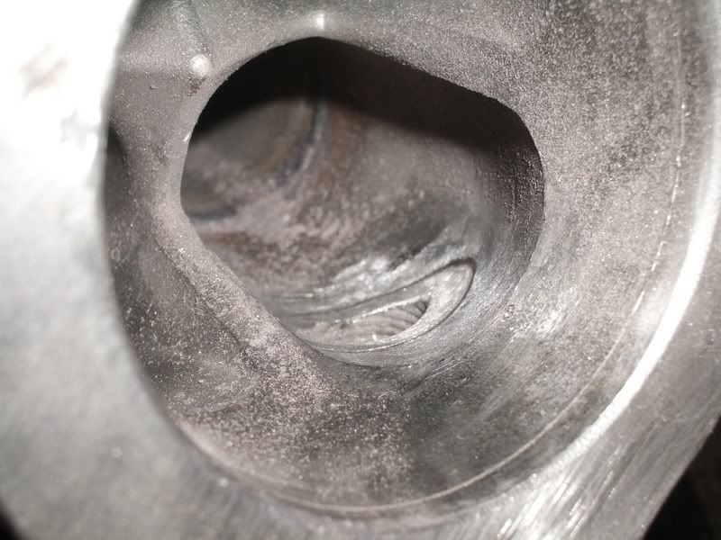

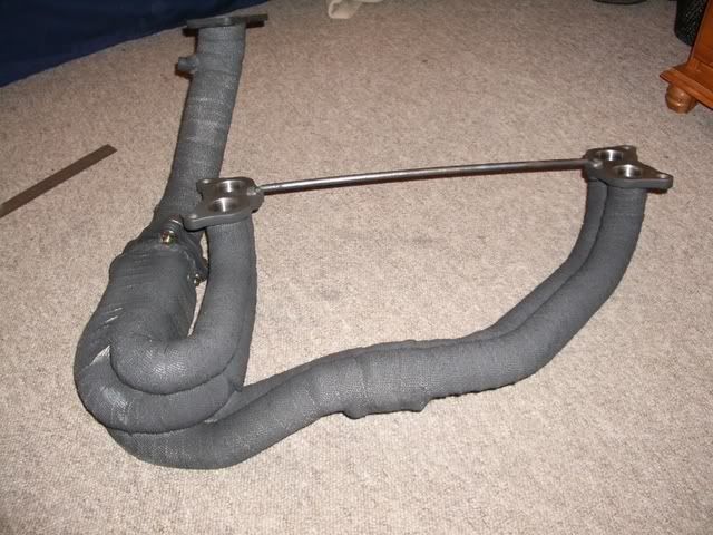

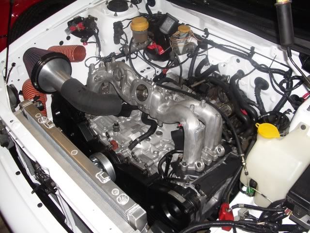

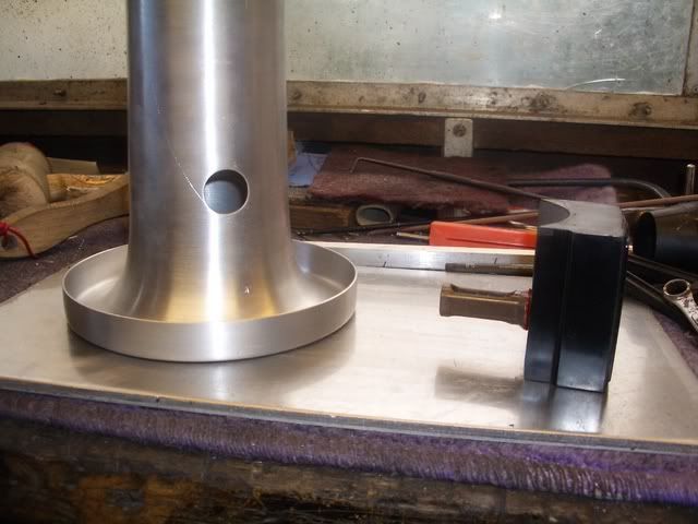

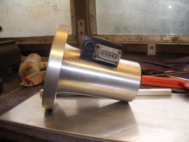

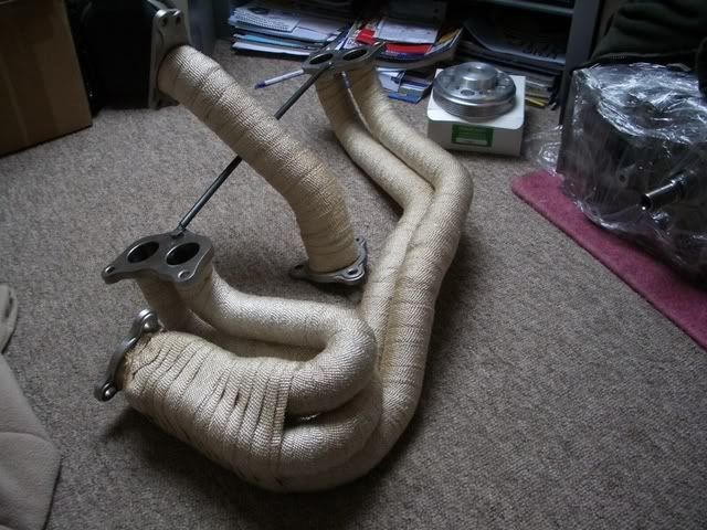

Kenny.S Posted January 12, 2007 Author Posted January 12, 2007 Happy new year all [] I'm offshore just now, on nightshift with nothing to do so i thought i'd do a wee update. The car looks pretty much as it did 3 months ago, but other things have been moving along slowly. I've had the headers for about 6 months but never got round to wrapping them. So while i was off over Christmas and New Year i decided to get on with it. First up was grinding off the protruding part of the lamba boss in the collector, forgot to take a picture before i started but anyone who's got a set will know what i mean. An hour or so with a die grinder and some sanding drums Once i'd done that i gave them a right good clean out and got them wrapped, not in the house!! I just brought them in to dry them out I dont know how effective the heat resistant paint is as stopping them soaking up water but i did the downpipe with the same stuff and had some left over so i figured i might as well use it. In for a penny in for a pound [] One 80mm air flow meter I havent bonded it in just yet, ill probably wait until i've got the inlet pipework fitted and then stick it in with some sikoflex. I had originally planned to put the air filter through the inner wing, but once the maf is bonded in the trumpet would be stuck there. Not like you would need to remove it very often but still, not ideal. Also the water ingress thing was at the back of my mind so i decided to put it behind the headlight and get as much air into it as i could. I've now got the heads back, and they look virtually brand new, they didnt need too much work afterall, the exhaust seats and exhaust valves were recut to remove some pit marks as is to be expected after 12 years, and some mild port work to blend the seats in. Didnt get a chance to take any pictures before i left but ill put some up when i start putting the engine together which will hopefully be when i get home after this trip. Kenny
the squiggle Posted January 12, 2007 Posted January 12, 2007 Looking good boss Where did you obtain the 80mm trumpet from? Look a neat solution to a good idea
jcscoob Posted January 12, 2007 Posted January 12, 2007 Kenny its all lookin real good[y], dig in mate your doin well [][h]
Kenny.S Posted January 12, 2007 Author Posted January 12, 2007 Mr Lateral I cant take credit for the idea though, it was Andy.F who suggested cutting the element out and bonding it into a bigger tube, this was just my interpretation of it. All will become clear in time []

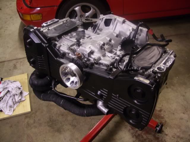

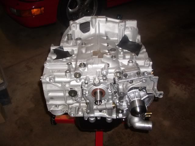

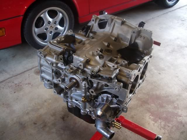

Kenny.S Posted January 22, 2007 Author Posted January 22, 2007 Finally...... something resembling an engine [] Next move will be to get the car towed up to the garage and put it in. That just leaves all the i/c pipes, power steering pipes, a few brackets and some wiring..... Kenny
scoobaroo Posted January 22, 2007 Posted January 22, 2007 That looks very tidy indeed, will look even better when its installed [H] Marty.
Kenny.S Posted January 22, 2007 Author Posted January 22, 2007 What engine stand is that? It's nothing special, it was an ebay effort, cost me something like £40 delivered, i could have bought an expensive one but i hope i dont have to use it that often!
fai17 Posted January 22, 2007 Posted January 22, 2007 And i see you've got a lightened pulley. How long now till your car is ready?
Kenny.S Posted January 22, 2007 Author Posted January 22, 2007 It wasnt so much because it was lightened, more the fact that i wanted a single pulley with 5 vee's, it would take too long to try and explain what i'm up to but all will become clear in time [] I'm not sure how much longer it's going to take, with any luck the engine might be in tonight and then i can make a start on all the bits i've got to make.

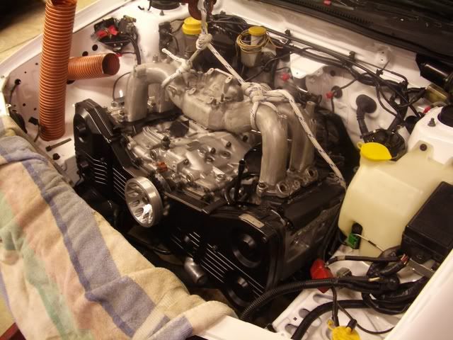

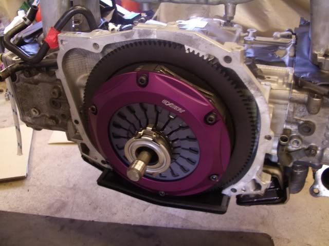

Kenny.S Posted January 23, 2007 Author Posted January 23, 2007 Had a pretty productive day. I went over to John Stevenson's in the morning to pick up a special clutch alignment tool [] Worked a treat too Then it was time to try and get the bugger in It actually wasn't too bad, half an hour or so and it was in The manifold thats on it just now was just to lift it in, i should hopefully get my reversed one back in a few days. Ill probably put the up pipe and turbo on tomorrow and then start working some things out, like where the header tank's going, power steering reservoir, pipes.... Kenny
drb5 Posted January 23, 2007 Posted January 23, 2007 Looks good as per Kenny, but errrrrrrrrrrrrrr "up-pipe"? Why isn't it on just now? Hoping you haven't gone and got yourself that naughty 3 bolt up-pipe!? [] Oh and i have that special clutch alignment tool here. Would have saved you some time........and of course listening to John dribble on. []
higgy Posted January 23, 2007 Posted January 23, 2007 Good luck with the 3 bolt up pipe when the engin is installed . Im sure there will be a fair amount of swering going on. Projects almost there now. Keep us posted. Higgy
