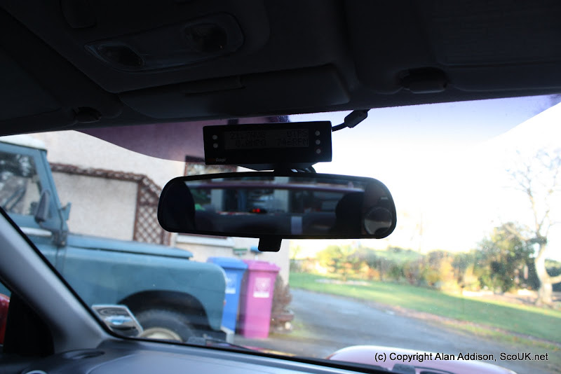

scouk Posted May 5, 2012 Posted May 5, 2012 (edited) Yeah ScanGuage-II still very much on the go.. Got mine off eBay from somewhere in Europe IIRC Not necessarily the cheapest device on the market but handy tool to have with plenty functionality without cluttering the dashboard! http://www.scangauge.com/ http://www.ebay.co.uk/sch/i.html?_from=R40&_trksid=m570.l2736&_nkw=scangauge-ii I got a pack with extra cable so I can quickly swap it between teh Ka and Scoob Not a great photo but also got a mount to tuck it up above the rear view mirror on the scoob For the ka it's jsut stuck on to the dash with velcro Edited May 5, 2012 by ScoUK
