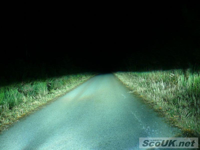

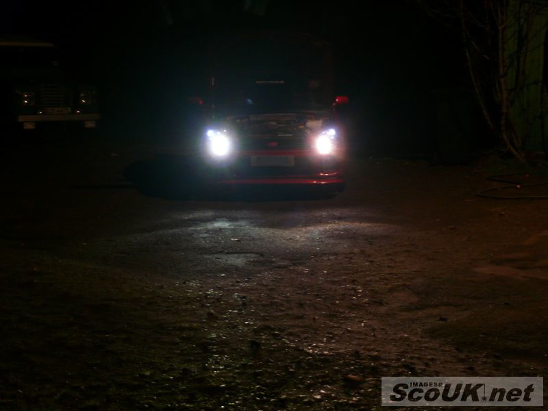

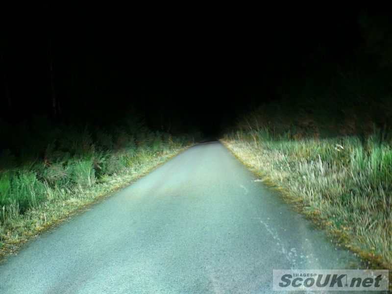

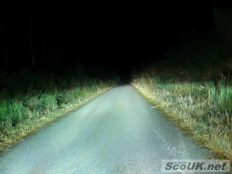

scouk Posted November 18, 2009 Posted November 18, 2009 (edited) Got my second Ballast today and fitted. No problems at all.. Not even one single misfire on the bulb BTW - Found a few photos I took last year when I first fitted them: One on the left is HiD (4300k colour temp), one of the right is regular bulb.. You can see the HiD appears brighter and probably a better spread of light across the ground.. Distance tests.. May be difficult to spot the difference at first but note even throughout all the 3 settings the dipped HiD clearly has an intense level of light. Dipped HID only: Good light coverage with sharp cut-off thanks to the projector lens. Dipped HiD and Full Beam: Full beam using Philips Blue vision bulbs Dipped HiD, Full Beam with Driving Lights (Hella 500FF's with Philips BlueVision bulbs): Little but more distance, doesn't really show up there due to the distant road, but get a nice extra hot spot of light durectly ahead As mentioned above, note even with all lights on the HiD light is clear to see over the rest! Edited November 18, 2009 by ScoUK
scoobykev Posted November 18, 2009 Posted November 18, 2009 Dipped HiD and Full Beam: Full beam using Philips Blue vision bulbs Does this mean your kit doesn't have a full beam with the HiD?
scouk Posted November 18, 2009 Posted November 18, 2009 (edited) Does this mean your kit doesn't have a full beam with the HiD? Correct.. Just in the dipped projectors.. The Sti / JDM headlight unit uses separate bulbs for each unlike standard WRX bugeye's which use twin filament H4 bulbs.. Have considered HID-ing the driving lamps though... But wanted to get the ballast bug sorted first... It's possible I'll go nuts and HiD the whoel lot at somepoint... assuming I find suitable space for all the ballasts Edited November 18, 2009 by ScoUK
scoobykev Posted November 18, 2009 Posted November 18, 2009 Correct.. Just in the dipped projectors.. The Sti / JDM headlight unit uses separate bulbs for each unlike standard WRX bugeye's which use twin filament H4 bulbs.. Have considered HID-ing the driving lamps though... But wanted to get the ballast bug sorted first...It's possible I'll go nuts and HiD the whoel lot at somepoint... assuming I find suitable space for all the ballasts Ah, just curious. I didn't realise there were different types, my kit does dip and main beam.
