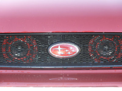

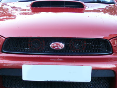

scouk Posted November 19, 2008 Author Posted November 19, 2008 (edited) Always liked the idea of re-painting the standard badge... The pink one was getting the odd strange comment along with the vinyl one not looking as good as the standard badge due to the flat stars, the standard badge is more 3D. Was toying with with the idea of doing either the scottish saltire (copied from Higgy) or just try colour coded in red mica.. Ended up deciding to go for the red mica.. So on a rainy morning, dug out my old badge and set to work sanding off the backing with some wet n' dry paper: When cleaned off all the black.. Gave it a quick polish to remove 90% of the fine scratches and gave it a quick wipe over with meths to clean the surface of chemicals before painting. Took about 3-4 light coats of paint, and here's the finsihed product along side an origonal badge Final Product... Lookin good! . o O (even if i do say so myself) Finally all fitted.. From a distance it's toned down the front, but the supertones behind the grille make up for it Edited November 19, 2008 by ScoUK
scouk Posted November 19, 2008 Author Posted November 19, 2008 So the supertones... Why? Erm... ok I admit, I try to make all my mods serve some "practical" purpose, like better aerodynamics, performance, safety e.t.c. But erm.. Ok I like the look of them.. Simple as that... Always fancied them but only avaialble from outside the UK generally.. When buying the Driving lights from a Hella reseller in the US I asked if he could do a deal with a set of supertones as well.. And sure enough I bought both.. Oh well.. May as well fit them then... Should really take more photos for this.. But fitting was easy.. at first I redid the wiring with a seperate relay e.t.c but in the end realised the standard horns were wired in the same way anyway and the wiring isn't too bad. So ripped out my wiring and reused the origonal while adding a couple short extensions and an earthing wires.. Mounting was more of an issue.. REALLY wanted them behind the grille.. Fortunately for the passenger side it was pretty easy just used the holes at the front of the frame where there are holes for the bonnet release cable! Perfect.. Added a few washers to space it back a bit so it's fits snugly behind the grille without hitting the radiator.. Wrapped the back in in tape anyway just incase it does impact the radiator.. Shouldn't. Driver side one was more of an issue due to the bleedin power steering cooling element.. tried a few ways at first but the space wasn't there.. So looked into relocating the cooler.. (I was really desperate to get the look of the twin horns behind the grille.) But nope relocating wasn't going to be so simple.. In the end, I decided to bend the brackets for the cooler just enough so the horn fits just snugly in there.. it's a tight fit but at least there's no pressure on the cooler.. again the back end of the horn has been wrapped in tape for protection it if it does come in contact with the cooler.. Will have to keep an eye on this incase it does start to impact the cooler... Anyhoo some piccies: Looks good from certain angles.. But really need to change the mesh, it's too dense.. and I've also clearly blocked off part of the radiator, so new mesh is in order.. Ive been on the lookout for the similar style mesh that is on the Hawkeyes.. Thin square/diamond with medium size holes.. In black.. Cant find the stuff anwywhere.. ANyone know where I can get a sheet of the stuff? P.s. Oh they are loud... VERY loud... Pretty quiet from inside, but stand infront of the car and yeouch!! No really.. it hurts!!

gus the bus Posted November 19, 2008 Posted November 19, 2008 Nice work Al . did the badge "thing" a few weeks ago myself and its so simple but very effective.
