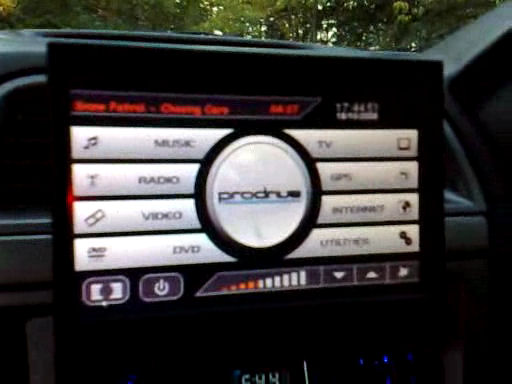

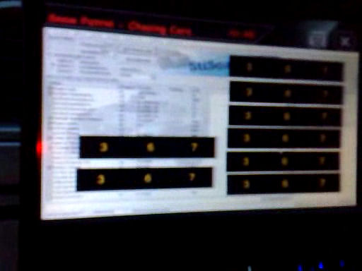

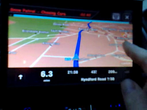

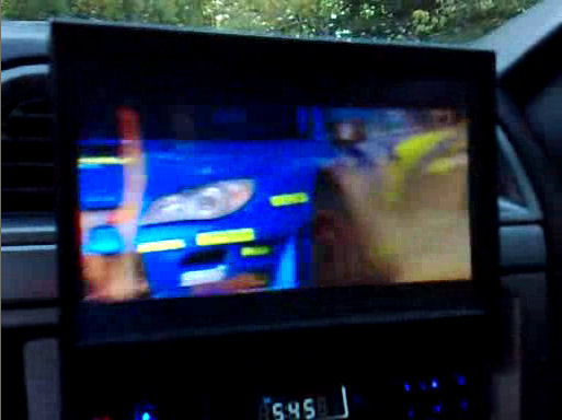

scouk Posted October 18, 2008 Posted October 18, 2008 (edited) Been working on this for a while now but haven't got as far as I'd of liked.. But getting there... Idea is to have an onboard computer on the car attached to a touch-screen display for doing all sorts of stuff liek sat-nav, video, photos, music, telemetry + more! Here's some quick pics from todays test: (Excuse the poor quality, pics were stripped from a video clip) The current Interface (can be completely altered to suit) Watch videos of TG on teh go! (Not the driver obviously) Real Time car telemetary & logging.. Interface need a bit of work... But have tested it seperately and it works! Only recently foudna suitable sat nav application for it... Was trying to get TomTom to work but it was too slow THis one is simialr though yet much quicker! All controlled via touch screen display! Looking promising so far... Just need to get the telemetry/gauges stuff sorted out, so it looks pretty, get rid of the annoying beep everytime the screen is touched. test a few more applications for potentially TV/Radio / Phone & a couple other things I havent mentioned and find somewhere to mount the PC in the car.. The possibilites are endless really.. Sadly it won't be able to enable attack-mode like the new KITT... I've got a video of the above but it's a bit big at the mo.. I'll try shrink it down to a sensible size and post it up later... Edited to add video now on YouTube - http://uk.youtube.com/watch?v=tr8Nakf55ig P.s. Tissy has a similar system installed on his own scooby Edited October 18, 2008 by ScoUK

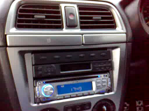

scouk Posted October 18, 2008 Author Posted October 18, 2008 Cheers guys.. Really hoping I can get it sorted the way I want it.. BTW - this was done with the laptop sitting ont eh driver seat so not a permanent fixture yet.. I do have an ITX system set-up but it's a little underpowered, may just need more memory... It's got a DVD WRiter as well at the mo Also couldn't get hte CutDown version of WindowsXP to install onto it properly last time I tried SO just just running it off the laptop at the mo.. Yeah the SatNav has been the killer for a few months Got TomTom working on a windows Mobiel emulator but was WAY to slow and processor intensive., but recently came across This one: http://www.sygic.com/ Other problem was finding software to attach to the car's ECU and still deliver a decent interface for gauges.. Came across StiScan which shoudl allow me to design my own gauges and stuff so with a bit of time that should be sorted too.. Sadly no real time map switching the software I use for mapping doesn't allow on the fly map swapping.... yet... Would be cool though! Could "potentialy" have any number of temporaty maps lined up.. (Woudl need to be V careful with that one though...) FYI - for anyone interested most of the InCarPC info can be found here: http://www.digital-car.co.uk/ (UK Based) http://www.mp3car.com/ (US Based - But MUCH bigger) Also here's TIssy's project page: (Where the interface was "borrowed" from ) http://www.wrx-carpc.co.uk/

scouk Posted October 19, 2008 Author Posted October 19, 2008 Link to it here: http://www.jkmentertainment.com/jkm/ Cool! I do prefer the double din screen looks much neater, but I couldn't quite tear myself away from the fact the PC woudl still need time to boot-up before you can play music. et.c. So for now wanted to keep a normal head unit in there (which will get upgraded to a DVD/MP4 player with USB port at somepoint) that way I can channel all the audio through the head unit.. DId look at alternatives like mounting a head unit in the top din and usign a dual din screen but didn't quite like that idea.. fair stretch to get to the controls.. The screen I have (although not 100% neat) works quite well and hides away into a single din when not in use.. Also will possibly be looking at getting a laptop with a broken screen for using instead of the ITX system as it means I can run teh system withut draining the car battery when the engine isn't running.. as I coudl use the built in laptop batter.. Similar mods can be made for hte ITX systems but they aren't quite as straight forward.. Perhaps later down the line get a seperate amp and kit out the boot and the rest of the car with a nice set of speaker, but that's WAY down the line from where I am just now...

scouk Posted October 20, 2008 Author Posted October 20, 2008 (edited) I'd really not need the sat nav stuff, 'cos I tend to know where I'm coming/going to and there are not too many speed camera locations on my normal routes either. The sat nav software I had running there also ahs a GPS logger, so you can log your routes.. Which coudl be kinda cool if our for a run and want ot find out where hell I really ended up! To try answer a coupel other questions. Yeah by the looks of things that package is XP based so in theory you coudl do whatever you wanted with it. Details are a we bit sketchy as to ports etc. so dunno if you can ad keyboards and stuff do it.. (Possibly Bluetooth actually) Some versions used to use Lunux for speed but with cutdown versions of XP on the go it's not really worth it given most software is XP based.. Ports wise, most things run off USB and if there isn't enough I was goign to add some ports into the center console where one of hte blanked off switches usually are.. infact was considering putting the power switch for it there somewhere.. AS for hte price tag.. I'm just a cheapskate and don't like paying for stuff I can do myself! (assuming I can do a reasonably decent job of it) I don't think I'd ever pay £750+ for such a device TBH...but that's me... Can't remember the exact spec of ITX system I have but I think it was aroudna 850Mhz process with onyl 128MB of RAM so it's clear the bottle neck is the ram.. Was goignt o boost it up to at least 1GB once I get somethign working and see if it's enough.. Not sure if the newwer high quality videos would play properly on jus the 850Mhz.. Might be a bit tight, but we'll see.. There are quite a few ECU monitoring apps out there, but not many actually give you a decent enough view that woudl look good on such a small screen.. I think I did pay somethign like £10 for hte STISCan (a.k.a. evoscan) software after months of searching for somethign suitable. It let's you create your own style of gauges and can quite neatly be run from the main interface.. (RoadRunner incase anyone's interested) If I ever get somethign up and running properly it will onyl get added to and maybe do away with the normal head-unit and put in a proper fixed 2din screen.. WE'll see.. early days... FYI - Screenshot of one of the sample gauges from STiScan: ALmost Skyline GTR style! (Need to Find a G-Meter ) More examples on this page. (scroll down a bit) - http://www.limitless.co.nz/ Edited October 20, 2008 by ScoUK
P1_Paul Posted October 20, 2008 Posted October 20, 2008 (edited) What software do you use to map? Edited October 20, 2008 by P1_Paul
scouk Posted October 20, 2008 Author Posted October 20, 2008 (edited) What software do you use to map? RomRaider... (Formerly known as Enginuity) http://www.romraider.com/ Wouldn't mind a shot of the ECUTek stuff but the licence is WAY too expensive... COmpared to Free OpenSource anyway (Did say I was a cheapskate... ) Edited October 20, 2008 by ScoUK
