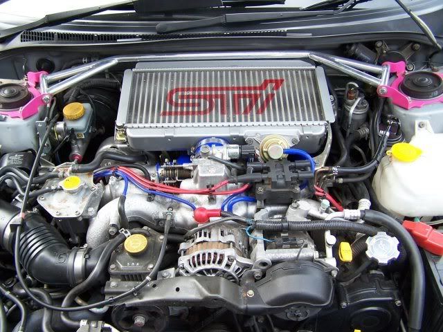

neill54 Posted September 22, 2008 Posted September 22, 2008 (edited) ive been thinking about a few things and wondered what the pro's and con's are in fitting one to a wrx?? and what else should be fitted along with it? neil Edited September 22, 2008 by neill54
thewelsho Posted September 22, 2008 Posted September 22, 2008 ive been thinking about a few things and wondered what the pro's and con's are in fitting one to a wrx??and what else should be fitted along with it? neil Why would you want to upgrade to a STi TMIC? On its own in a standard car, it does't offer very much.
neill54 Posted September 22, 2008 Author Posted September 22, 2008 thats the kind of reply im after welsho jsut been talking about stuff today and this was mentioned i can see that the sti one is slighty bigger but just wanted to know really still trying to learn all about subaru's what about ic spray then? and hopefully it wont be that standard for long neil
paul555sti Posted September 22, 2008 Posted September 22, 2008 Neil the intercooler upgrade is a good thing as part of other mods ( getting a remap ), on its on you wont see too much improvement. I have an intercooler spray set up you could have if you want it. Since i fitted my front mount it isnt used anymore but again i am not sure how much benefit it would actually give you.
WUZ Posted September 22, 2008 Posted September 22, 2008 STI TMIC has larger surface area therefore better cooling of charge temps. lower charge temps are good for any turbocharged car. STI TMIC has Alloy "Y" pipe and silicon hose, not the cheap Black Plastic pipe that can split with age and under higher than average boost (they can go @ 1.3 Bar!) 2 good reason to upgrade there (unless you have the PPP Silicon "Y" pipe in which case its only 1)! Russell
neill54 Posted September 22, 2008 Author Posted September 22, 2008 see now im getting somewhere so would i be better off doing both if i could with the silcone pipe etc ideas at the mo is to uprate fuel pump maybe bigger injectors possibly a new intercooler(frount mount hopefully but cash flow might depict just the sti one etc) car is fully decatted whats my best route really not really after big power just reliable good power with good boost neil
emoe Posted September 22, 2008 Posted September 22, 2008 see now im getting somewhere so would i be better off doing both if i could with the silcone pipe etc ideas at the mo is to uprate fuel pump maybe bigger injectors possibly a new intercooler(frount mount hopefully but cash flow might depict just the sti one etc) car is fully decatted whats my best route really not really after big power just reliable good power with good boost neil If the intercooler will fit straight on then its a good investment if you dont want to go for a front mount. Especially if you have the old rubber hose to the IC. WUZ is right, they are HUGE compared to the WRX or std one, and so they will offer better cooling. HOWEVER, IMHO you need to rig some sort of shield up for the left hand side as they draw a lot of heat from the turbo and exhaust side. Its not necessary but a great mod if you can do it. If youre seriously looking at chaing the pump injectors and a remap, and would consider a front mount then dont waste the money on the TMIC, just wait and get a bog front mount.
thewelsho Posted September 22, 2008 Posted September 22, 2008 If the intercooler will fit straight on then its a good investment if you dont want to go for a front mount.Especially if you have the old rubber hose to the IC. WUZ is right, they are HUGE compared to the WRX or std one, and so they will offer better cooling. HOWEVER, IMHO you need to rig some sort of shield up for the left hand side as they draw a lot of heat from the turbo and exhaust side. Its not necessary but a great mod if you can do it. If youre seriously looking at chaing the pump injectors and a remap, and would consider a front mount then dont waste the money on the TMIC, just wait and get a bog front mount. Front mount? An STi TMIC is good for over 400bhp so a FM is overkill for the sort of moderate upgrades that Neil is suggesting. Andy.F suggested my getting one when I got my car mapped on the standard WRX TMIC, so I did. I went back to him for some tweeks and the there was practially no change in power outputs with the STi TMIC. The only reason to uprate your intercooler is for safety reasons, it is a support mod as opposed to a power mod. Might I also be correct in saying that due to the longer pipe-runs with a FMIC, more lag is introduced.
paul555sti Posted September 22, 2008 Posted September 22, 2008 Front mount? An STi TMIC is good for over 400bhp so a FM is overkill for the sort of moderate upgrades that Neil is suggesting. Andy.F suggested my getting one when I got my car mapped on the standard WRX TMIC, so I did. I went back to him for some tweeks and the there was practially no change in power outputs with the STi TMIC. The only reason to uprate your intercooler is for safety reasons, it is a support mod as opposed to a power mod. Might I also be correct in saying that due to the longer pipe-runs with a FMIC, more lag is introduced. Not sure what age Neils car is but if it is an early classic then it will have the slanted top mount. Replacing this with the newage intercooler is quite a big job. When i was modding mines i spoke to Andy and he said normally the top mount is the way to go but on the early cars the front mount is the best option. As far as the lag goes well i am more than happy with how mines performs with the front mount.
emoe Posted September 23, 2008 Posted September 23, 2008 Front mount? An STi TMIC is good for over 400bhp so a FM is overkill for the sort of moderate upgrades that Neil is suggesting. Andy.F suggested my getting one when I got my car mapped on the standard WRX TMIC, so I did. I went back to him for some tweeks and the there was practially no change in power outputs with the STi TMIC. The only reason to uprate your intercooler is for safety reasons, it is a support mod as opposed to a power mod. Might I also be correct in saying that due to the longer pipe-runs with a FMIC, more lag is introduced. You are right with the lag JD but the benefits are better. Early cars are hell to retrofit the newer TMIC so fmic is the way to go. Also TMIC does drag heat from the engine bay and therefore can cause DET to occour earlier.

frank c Posted September 23, 2008 Posted September 23, 2008 Firstly - fitting, say, an sti7 tmic to a classic is a total of a job. Are you sure ??
emoe Posted September 23, 2008 Posted September 23, 2008 Are you sure ?? I am!! i tried a while back and the whole intercooler needed some major mods with someone with a tig-welder. The unit will fit in nicely, but it hits against the IAC valve and has to be cut back about 10 mm in that area.
frank c Posted September 23, 2008 Posted September 23, 2008 (edited) I am!! i tried a while back and the whole intercooler needed some major mods with someone with a tig-welder. The unit will fit in nicely, but it hits against the IAC valve and has to be cut back about 10 mm in that area. But Scoobysounds has a version 5/6 Edited September 23, 2008 by Frank C
emoe Posted September 23, 2008 Posted September 23, 2008 But Scoobysounds has a version 5/6 but was it modded to fit? and also does he have a Phase 2 engine? Mine is a phase 1.5 and they dont fit without the mod
emoe Posted September 23, 2008 Posted September 23, 2008 (edited) That is a pain as you have to weld the new one!!! most people dont have a tig welder lying around! Edited September 23, 2008 by emoe

colin_ross Posted September 23, 2008 Posted September 23, 2008 Why? - Fit basically. The slanty i/c you have isn't and easy swap with the newage top mount as mentioed. A front mount may cost more depending on what type you buy and there will be more involved in fitting it i.e. you'll have to cut you bumper and it may introduce more lag. It's a pain of a job but less so than a tmic in your case. The charge temps will be better though and if top speed runs are your thing it will be safer.
neill54 Posted September 23, 2008 Author Posted September 23, 2008 theres where my lack knowledge of turbos and intercoolers gets me im used to my old pug 205's top speed runs are not my things its how you get there that counts really ive had my car for over 2 years now enjoyed every minute nearly ,it came limited and still is to 112 mph so what im after is more of a drag type car but just for the road so is it all in the torque? neil
wilky Posted September 23, 2008 Posted September 23, 2008 (edited) theres where my lack knowledge of turbos and intercoolers gets me im used to my old pug 205'stop speed runs are not my things its how you get there that counts really ive had my car for over 2 years now enjoyed every minute nearly ,it came limited and still is to 112 mph so what im after is more of a drag type car but just for the road so is it all in the torque? neil In that case its the STI T/M you want. Anything can be made to fit, if you need to get creative then so be it. You will need to lose the "guts" out of your scoop and it would be a good idea to get an new STI scoop copy that will fit a classic to ensure good air flow. You can channel the air onto the new topmount by surrounding it with foam rubber strips. heatsoak is always a drama even with a fmic, once you start moving forward the air cools it anyway. With a heatshield it just holds the heat as well, been there tried that. Yes it induces det, but are you going to run 500bhp and try to win TOTB? No. So relax. With a decent TMIC compared to a FMIC with the power you are looking at the difference is about 1bhp so save yourself the expense and work out how your going to shoehorn it in. Borrow one, take it home and work out how your going to do it. I fitted one into a leggy GTB which really shouldnt have the space either, but I did it. Slightly later than yours but there you go. This cost £310 to do. Callum W Edited September 23, 2008 by Wilky
colin_ross Posted September 23, 2008 Posted September 23, 2008 Callum, that's a phase 2 motor which is a piece of p!ss to make it fit. The OP has a phase 1, I wouldn't even try to make it happen.
wilky Posted September 23, 2008 Posted September 23, 2008 Callum, that's a phase 2 motor which is a piece of p!ss to make it fit. The OP has a phase 1, I wouldn't even try to make it happen. I know. It can be done. Callum W
colin_ross Posted September 23, 2008 Posted September 23, 2008 I'm sure it can, doesn't make it a good idea though. I'd be looking for a fmic and saving myself a load of hassle. All in my humble opinion of course
