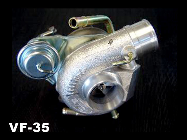

thewelsho Posted May 7, 2008 Posted May 7, 2008 (edited) An wastegate is what vents off excess pressure on the hot side of the turbo stopping it spinning it too hard. It has a spring that holds it shut but when a certain pressure is reached (depending on how strong the spring is) the wastegate opens and releases the pressure. Boost controllers can bleed away some or all of this pressure to make your car run the desired amount of boost.An external wastegate is one that it not part of the turbo whereas the normal ones are built into the turbo. The reason's for going external is that you get to a point when you're running a bigger turbo where a bigger w/g is required to vent enough gas. The built in ones are restricted in size but the external ones can be a big as you like. There are other benefits regarding exhaust gas flow too as the exit from the turbo isn't disturbed when it is kept seperate. You know too much... do you ever get out!? Don't suppose you could post an annotated pic of a turbo showing the wastegate? Edited May 7, 2008 by TheWelsho

colin_ross Posted May 7, 2008 Posted May 7, 2008 Don't suppose you could post an annotated pic of a turbo showing the wastegate? The round silver part on the front of the turbo is the actuator, this is connected to the wategate on a standard turbo via a rod. When the actuator is pressurised it pushes the rod and open the w/g The w/g is the hindged part inside the turbo to the right od the impeller. The penny as it is called it opened to release the pressure down the downpipe.
thewelsho Posted May 7, 2008 Posted May 7, 2008 The round silver part on the front of the turbo is the actuator, this is connected to the wategate on a standard turbo via a rod. When the actuator is pressurised it pushes the rod and open the w/g The w/g is the hindged part inside the turbo to the right od the impeller. The penny as it is called it opened to release the pressure down the downpipe. Top man

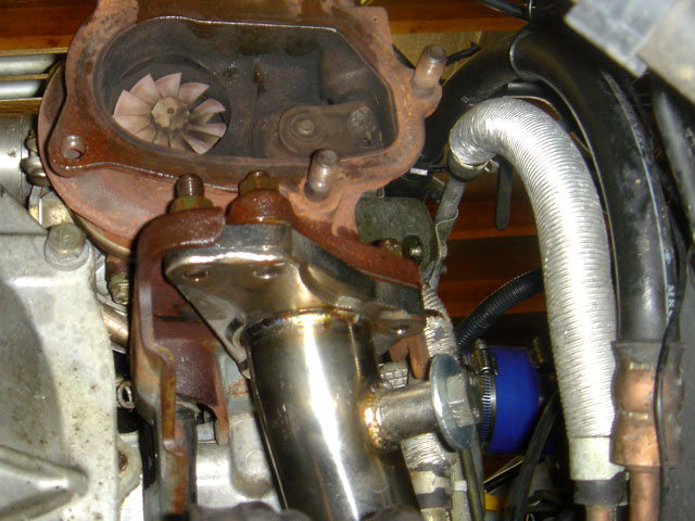

Boydie. Posted May 8, 2008 Posted May 8, 2008 (edited) chirpy, chirpy blow off valve. Anything but! I thought the chirpy chirpy was because they were not running blow off valves, and that said noise was actually the turbo cutting through the compressed air that had no where to go? Pretty much. It's called Compressor surge, the chirpy/flutter noise is air travelling back through the the turbo after the throttle plate closes. When you're watching Rally, listen to the cars. They give off MEGA flutter due to Anti-Lag, awesome noise! John, these pictures might help a bit. External - Internal - On a side note, can anyone tell me if any of the WRX/STI turbos are VV? Edited May 8, 2008 by Boydie.
