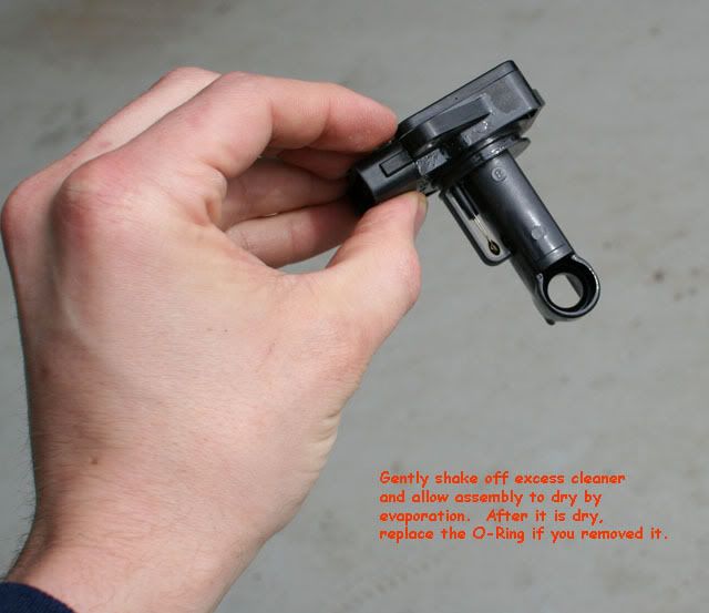

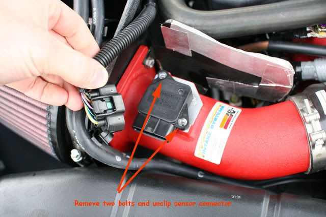

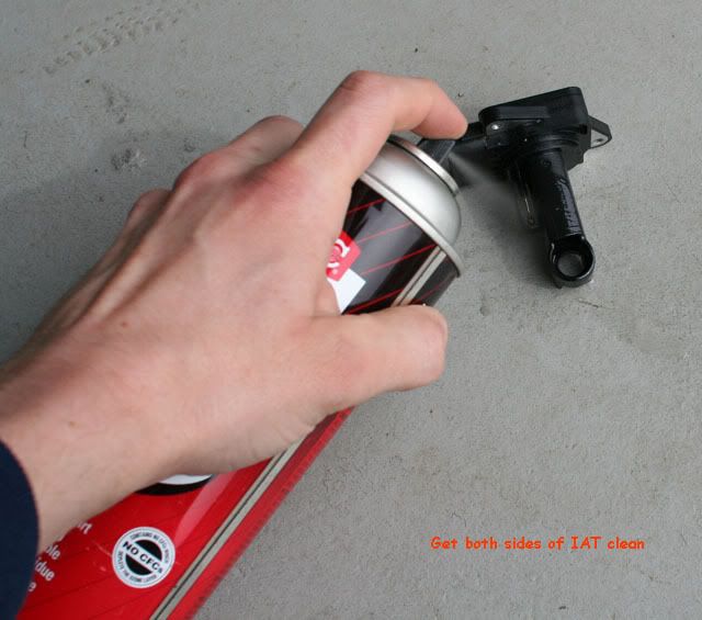

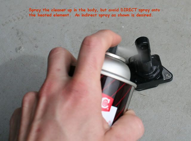

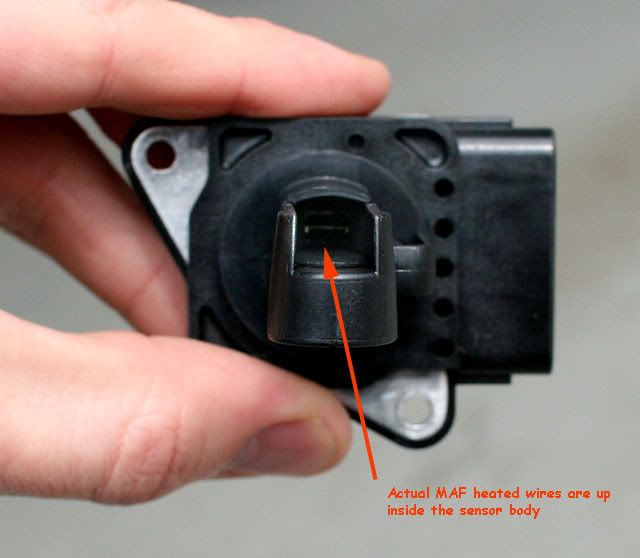

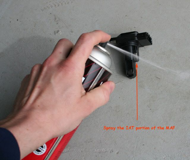

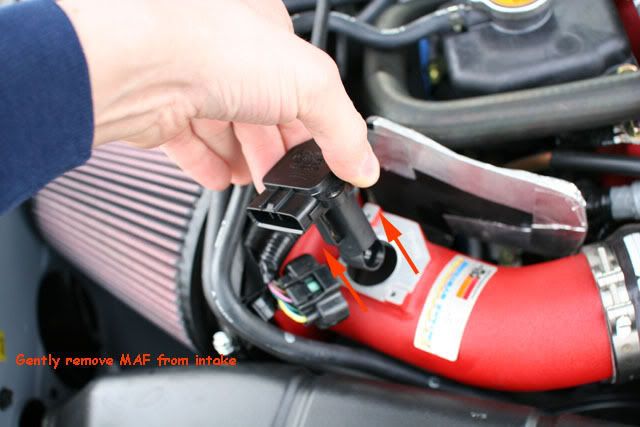

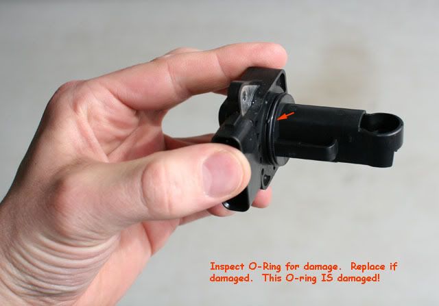

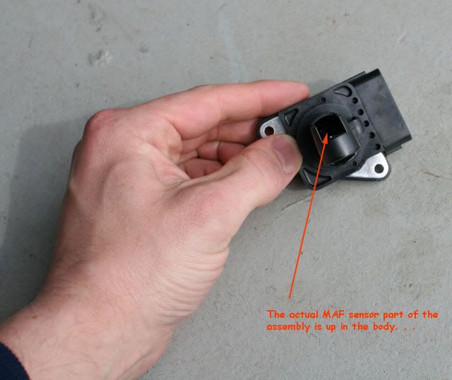

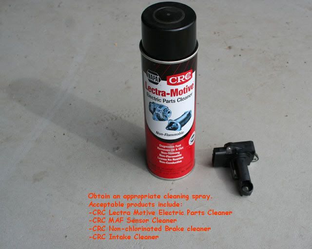

scoobaroo Posted September 17, 2007 Posted September 17, 2007 For future reference John, heres procedure for MAF cleaning Marty.
thewelsho Posted September 17, 2007 Author Posted September 17, 2007 For future reference John, heres procedure for MAF cleaning Marty. Wow! Nice one Marty. Perhaps you could have this wee tutorial posted elsewhere on the forum as a guide for other users too.
