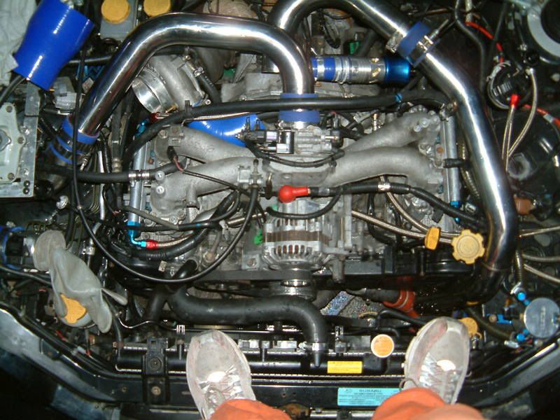

AlanG Posted May 26, 2007 Posted May 26, 2007 Just asking a question regards the way the turbo is postioned ie i know its the only way to get a bigger turbo on a impreza for room wise but how much difference is there over the downpipe and uppipe on the standard postion turbo to running the turbo at that angle??? Not sure what you mean dipsy. The rotated setup has a different flange for the up-pipe to suit the GT series turbos and downpipe flange. The only real difference is the shape of the downpipe because of the angle of the turbo outlet. The up-pipe is "similar" to standard, not a great deal in it. Because of the size of the inlet (usually 4"), it's better to rotate to allow an inlet pipe to fit plus give the inlet air a straighter path to the compressor.

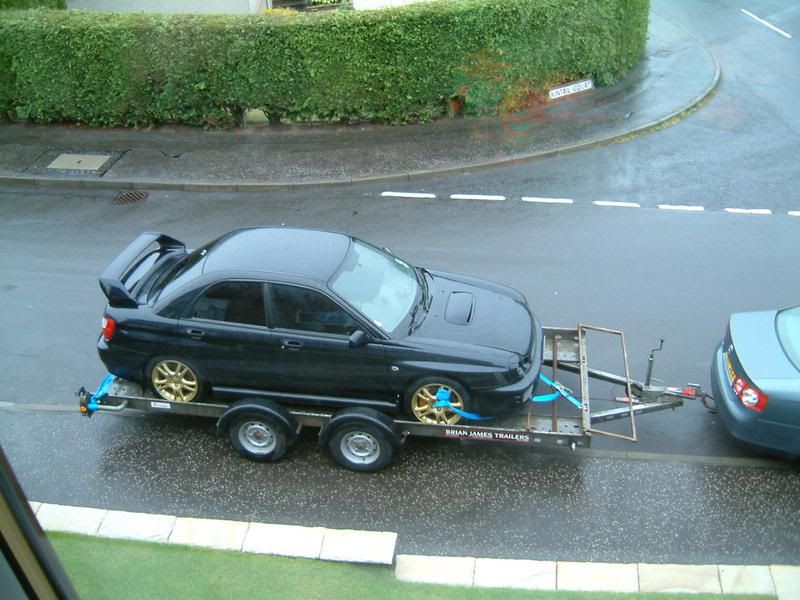

higgy Posted May 30, 2007 Author Posted May 30, 2007 She's on the final leg of the journy. here's hoping all goes well. Higgy
