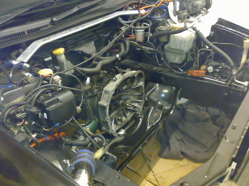

jcscoob Posted December 17, 2006 Posted December 17, 2006 Whaaaa !!!! [] Bloodie hell mate, thats some thing that, get the cu*t straped on [y][y] []
colin_ross Posted December 18, 2006 Author Posted December 18, 2006 I'm done when it comes to rushing things Jon, gonna take my time and do it right this time. Be ready by the start of the season.[]

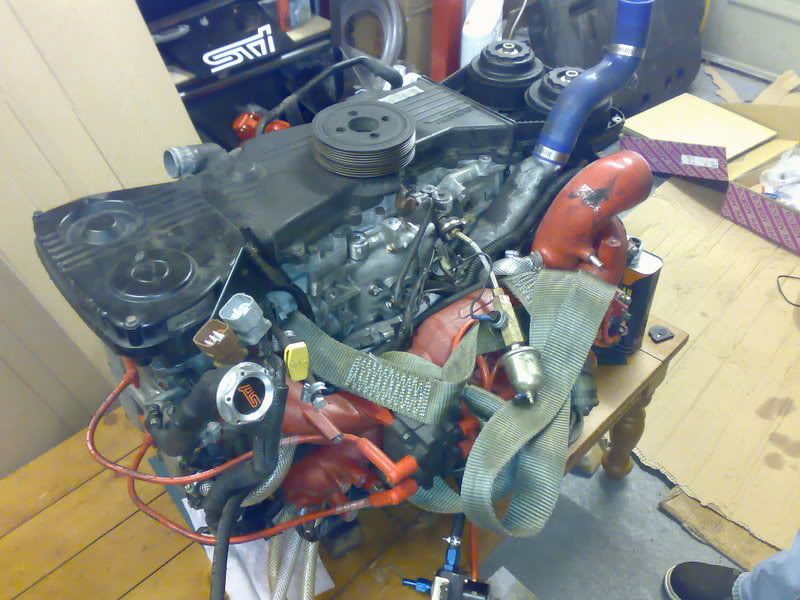

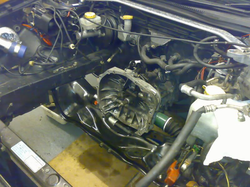

colin_ross Posted February 7, 2007 Author Posted February 7, 2007 Progress!!!! Here's how she stands And here is the main attraction, 2.33 litres of fully forged goodness. Dosen't look like much but that's the way I like it. Soon to be fitted with this bad boy Seems a shame to hide it away down there. Anyway, next few weeks will consist of stripping and cleaning and then maybe think about putting it all back together, the hit list goes....... Fit new turbo, headers, upipe, downpipe Helicoil turbo oil feed on head Remove entire fuel system and replace with -6 setup Raise inlet manifold Remove and reseal sump Remove all vta breather hose and replace with catch can Fit new clutch and flywheel Replace steering rack with ultra quick rack Replace alternator, crank and power steering pulleys with lightweight underdrive numbers Fabricate new intercooler pipework to accomodate relocated turbo Relocate avcr solenoid next to external wastegate Then there is a bunch of other stuff thats got nothing to do with the engine like fit the 6 pots and whiteline goodies. Should all be done by this time next year at this rate.

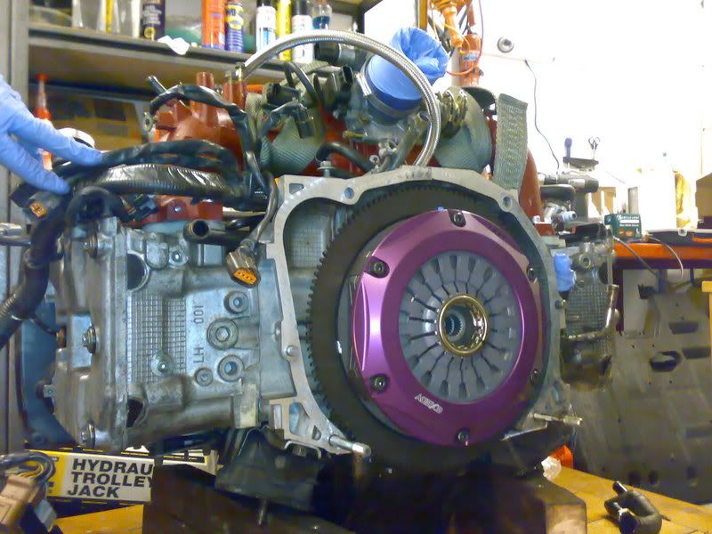

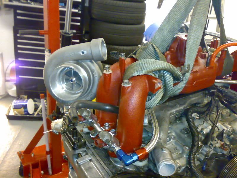

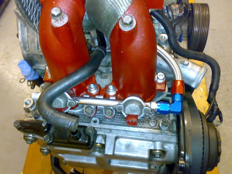

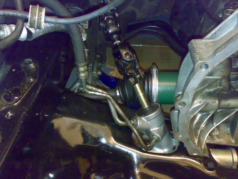

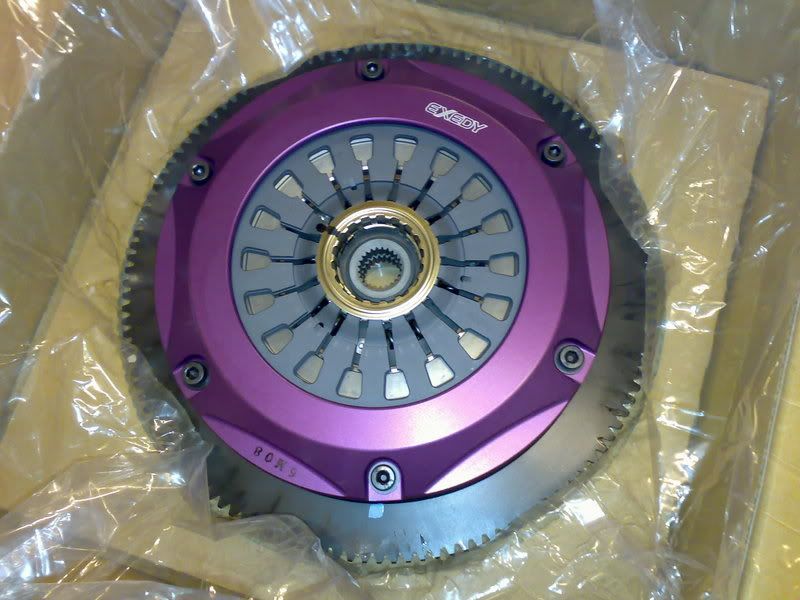

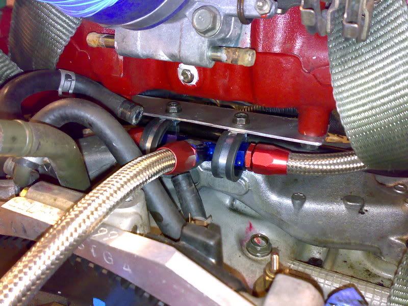

colin_ross Posted March 23, 2007 Author Posted March 23, 2007 Well it's really starting to get there now. Family ties and problems at Playsatan Central (johns jokes and Coulty in general) have held us back a little but it's starting to gain momentum now. Rear crank seal replaced and exedy twin goes on. Flywheel is a hefty 5kg so will have to take it easy off the line now. Yeah right. The new fuel system starts to take shape. Bling bling. The ultra quick rack is fitted. It should really be in a newage spec c so some persuasion was required The more I look at this turbo the smaller it seems. Maybe just sell it now and buy a really big one rather than going through the montions of running it for 6 months as per usual. As always big thanks go out to Satan's little helpers. Next week, it goes in the car []
