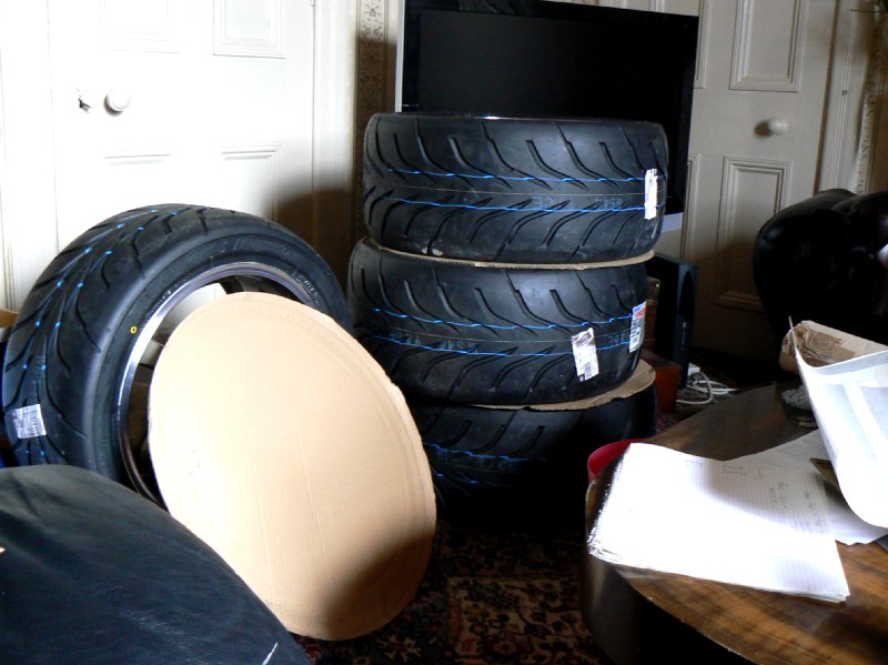

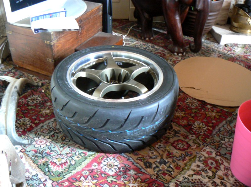

New stickers, wheels and tyres for the weekend
Just need to get the car back from the garage now!
