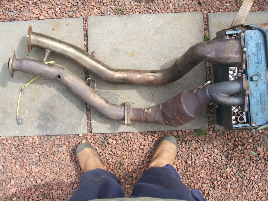

patsy Posted July 5, 2010 Author Posted July 5, 2010 so this is an aftermarket job?who makes it? i rember someone on here ended up using a newage centre on a classic downpipe as it was shorter. i think you must have a classic did the guy actually have this fitted and if so what make centre and rearbox did he have? The decat dp I'm trying to replace my prodrive dp with is a 3" bellmouth wolfrace one. I'm going to try popping out and taking a couple pics. Then come back in and try learning how to get them on to here for all to see?!!
patsy Posted July 5, 2010 Author Posted July 5, 2010 Here are a couple quick snaps......... http://i741.photobucket.com/albums/xx59/Ip...50/DSCF0981.jpg http://i741.photobucket.com/albums/xx59/Ip...50/DSCF0978.jpg Hope these help. Ryan

gus the bus Posted July 5, 2010 Posted July 5, 2010 Ryan, The bellmouth DP in the pic looks like a classic one so, If thats been on a WR1 it must have had the classic centre section fitted (classic centre is about 3" longer than the newage) so would make up the difference required. Personally I'd be trying to get the £'s back rather than bu$$ering about with different exhaust parts and buying a newage downpipe. S304 stainless ones can be had for £150 or so. Gus

patsy Posted July 9, 2010 Author Posted July 9, 2010 only just seen this post!offshore at the moment and just gotten internet acces! i sold ryan the decat pipe and it came off a smashed wr1 which had a full stainless system on it! wuz from bhp developments can confirm this as it was stripped at his house! have you managed to get a measurment of the centre section? also could it be that there are different system between bug eye,blob eye? as i know the hawk eyes are different to blob eyes? Pm'd you Bob. Deffo looks to be a classic down pipe. It has been compared against newage and classic setups and matches classics perfectly. Measures 90mm shorter than newage downpipe. Seems you must have had a classic system on your wr1? Got it sorted now anyways. Welded on the extra length needed to make it fit! All good.... Ryan
