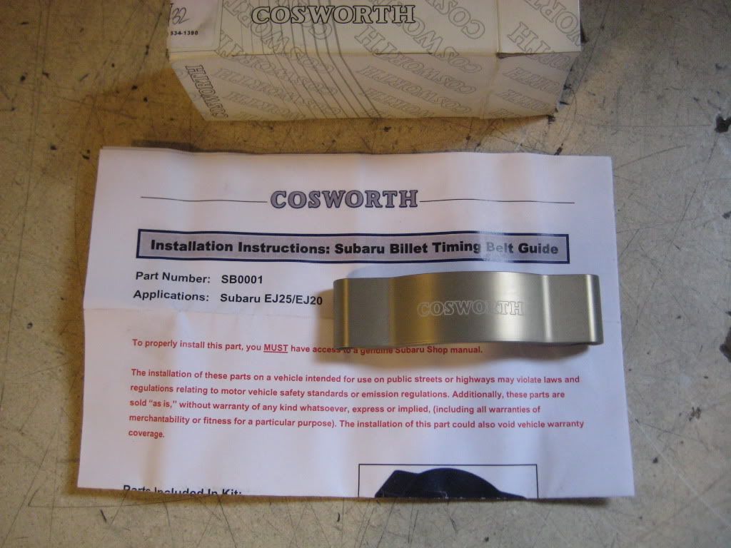

G.Mac Posted June 8, 2010 Posted June 8, 2010 Alright folks, as you know the car has been off the road for a wee while now after my spark plug incident. Anyways my sump has now been ordered so my ingine is going into the final construction phase anyways a few pics block sourced for $600 UDS gone from this To this Crank with improved oil ways and converted to ctr thrust setup couple of pics of the dual AVCS heads and a random Cosworth bit will throw up more pics as I get them Graeme

arch Posted June 8, 2010 Posted June 8, 2010 Graeme will be interested to see how you get on with the cosworth belt guide, I had one and could not get it to fit it rubbed on the belt no matter how much i tried to adjust it i used feeler blades for hours trying to get it to fit. In the end i sent it back so would suggest you check the clearance carefully when you fit it
