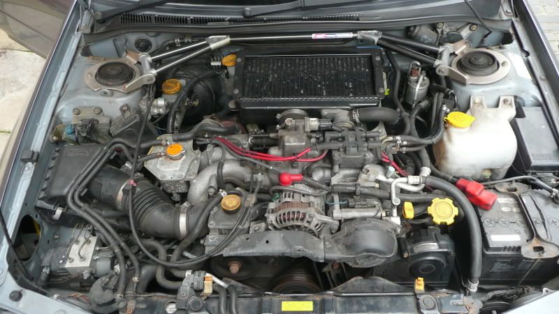

wilky Posted September 23, 2008 Posted September 23, 2008 I'm sure it can, doesn't make it a good idea though. I'd be looking for a fmic and saving myself a load of hassle. All in my humble opinion of course Totally with you Colin, but im looking from a money saving point of view, hassle, yes a bit of fiddling with the right angle intake on a TD05 but its not as hard as people make out. Callum W
wilky Posted September 23, 2008 Posted September 23, 2008 I stole that picture off the net, You would need to borrow one and watch for metal to metal contact and the 90degree turbo intake as well as the hoses and pipework below the intercooler before you decide if you were brave enough. Callum W
colin_ross Posted September 23, 2008 Posted September 23, 2008 That and the phase one throttle body sit much closer to the bulkhead so getting your square peg to fit in a slanty hole has to be overcame as well.

neill54 Posted September 24, 2008 Author Posted September 24, 2008 heres my bay at the mo needs a clean and its defo a phase one!! neil
