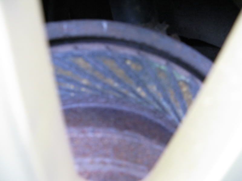

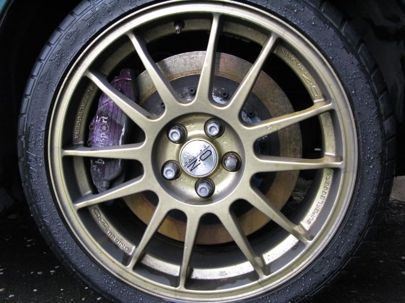

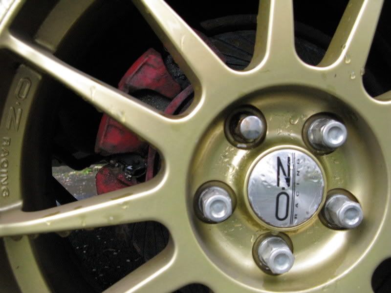

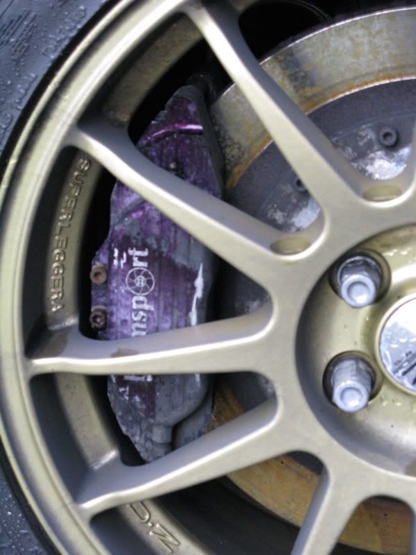

Typer666 Posted August 19, 2008 Author Posted August 19, 2008 Welcome on board mate, this lot will see you right P.S Type-r means something different here Heres some images - rears fronts You guys are right - I need to make sure the car is working fine standard before modding it. The brakes are the first thing that need attention - let me know what you think from the images

emoe Posted August 20, 2008 Posted August 20, 2008 You have standard calipers on the rear (sliding calipers) so pads for those will be easy, also the disc itself will be simple to locate. The fronts are Bremsport 6 pots, so youll need to get the right size disc (i think they were 322mm but someone may correct me on that... please!) The pads will also need to be the correct fitment, and im not sure where to get them or what others fit. Im not all that up on Bremsport, They are definently better than the standard sliders or 4 pots, so the brake system is a good one you have. The rear discs LOOK like Tarox 40 groove, but to be honest, any disc will be better than worn, warped ones. Those calipers look a bit manky on the back, get yourself an old toothbrush and cleam them off good with some decent cleaner when you change the pads and disc. If you are changing the pads and discs yourself, touch my goat and ill talk you thorugh it. As i said before, make sure the fronts are working properly too, and if i were you i would change the brake fluid. nice car by the way, hope youre pleased with it.
Typer666 Posted August 20, 2008 Author Posted August 20, 2008 You have standard calipers on the rear (sliding calipers) so pads for those will be easy, also the disc itself will be simple to locate.The fronts are Bremsport 6 pots, so youll need to get the right size disc (i think they were 322mm but someone may correct me on that... please!) The pads will also need to be the correct fitment, and im not sure where to get them or what others fit. Im not all that up on Bremsport, They are definently better than the standard sliders or 4 pots, so the brake system is a good one you have. The rear discs LOOK like Tarox 40 groove, but to be honest, any disc will be better than worn, warped ones. Those calipers look a bit manky on the back, get yourself an old toothbrush and cleam them off good with some decent cleaner when you change the pads and disc. If you are changing the pads and discs yourself, touch my goat and ill talk you thorugh it. As i said before, make sure the fronts are working properly too, and if i were you i would change the brake fluid. nice car by the way, hope youre pleased with it. Thanks for your help - I love the car!!! How do I check the calipers etc - I have never changed pads/disc before.... Contemplating it but not sure yet if I will do it myself. Looking at prices on the internet - looking pricey - 1) tarox drilled+grooved discs rear £180 + £70/90 mintex/ferodo ds pads... 2) front discs + pads ( I don't even know where to looks for discs pads for the front due to the size? Bremsport closed down because the owner died and starting trading under compbrakes butn now do only race spec stuff) 3) checking/servicing the calipers so quite expensive but as you say cheaper than a life. What do you think? Thanks
emoe Posted August 20, 2008 Posted August 20, 2008 Thanks for your help - I love the car!!! How do I check the calipers etc - I have never changed pads/disc before.... Contemplating it but not sure yet if I will do it myself. Looking at prices on the internet - looking pricey - 1) tarox drilled+grooved discs rear £180 + £70/90 mintex/ferodo ds pads... 2) front discs + pads ( I don't even know where to looks for discs pads for the front due to the size? Bremsport closed down because the owner died and starting trading under compbrakes butn now do only race spec stuff) 3) checking/servicing the calipers so quite expensive but as you say cheaper than a life. What do you think? Thanks I think you can just get standard discs on the back, you dont need tarox ones. Std ones will be much cheaper. pads id stick with those ferrodo ones. front pads id look at getting the pads out and matching them to the ones that come with AP 6 pots. Im sure they used a generic type of pad, or you may find they had 4 pads to each caliper. Basically remove the caliper, and using soapy hot water and an old toothbrush, scub the inside of the calipers good, then make sure the cylinders are all free. youll have to push them back in to service the pads anyway. If youre not competent to do it IN ANY WAY, or you are SLIGHTLY nervous, then get a pro to do it. brakes saves lives. Pay the money and have it done properly. Unless youre near me and ill do it with you for free.
Typer666 Posted August 20, 2008 Author Posted August 20, 2008 I think you can just get standard discs on the back, you dont need tarox ones. Std ones will be much cheaper.pads id stick with those ferrodo ones. front pads id look at getting the pads out and matching them to the ones that come with AP 6 pots. Im sure they used a generic type of pad, or you may find they had 4 pads to each caliper. Basically remove the caliper, and using soapy hot water and an old toothbrush, scub the inside of the calipers good, then make sure the cylinders are all free. youll have to push them back in to service the pads anyway. If youre not competent to do it IN ANY WAY, or you are SLIGHTLY nervous, then get a pro to do it. brakes saves lives. Pay the money and have it done properly. Unless youre near me and ill do it with you for free. Where are you located? I'd like to learn how to do it from someone who know's what they are doing Thanks:D

emoe Posted August 21, 2008 Posted August 21, 2008 (edited) - 1) FIRSTLY - Rear pads/discs too corroded, the brakes hardly work so getting the 6 pot calipers at the front and rear 2 pots serviced then new dics and pads all round thinking ferodo ds 2500 pads? Price £....? prices vary. 2) Full main service, cambelt check, gearbox and diff oil checked. Price £....? prices vary! check around This is the stuff im thinking ahead about...... But i need to get the breaks and service/inspection done immediately the next few days - don't want to take any chances, not driving the car till it gets done. 3) Everything being ok - its goin on the dyno. Price £....? (hypertech next week £40? if stage 1 & 2 successfuly completed) Why spend £100 on a dyno run for absolutely nothing?? If the car is standard, youll look at the region of 220Bhp 4) Then suspension mods, (already has springs) strut brace, roll bars, drop links and a fast road geometry set up to top it off. Price £....? SEE NOTE 7 BELOW 5) There is a tunning package taking it to 280-300bhp - ( as per andy forrests website) Price £....? You may get 280Bhp out of that set up on your car, but id be suprised if you did. Your car has 380Injectors, which are running at full chat at 260Bhp. The original TMIC isnt brilliant, and you need better cooling for more power. the original TD04 runs out of puff at 280 Tops, and the dumpvalve, plugs, pressure reg and walbro pump do NOTHING to raise the power. they are mods that become neseccary as you progress. The pump i would say deffo change. Regulator?? Not needed under 350bhp, and the sports exhaust is a good investment, but to reach that 280bhp youll need to change headers and up-pipe and downpipe on your car as they are restrictive. I would estimate with a remap and a sports exhaust and that induction system youd see about 260bhp. Full Decat or Sportscat exhaust from turbo back 2.5 or 3” bore Walbro 255 l/hr uprated fuel pump Apexi Induction system with resonator delete ESL custom live mapping of original ECU Fuel Lab turbo specification fuel pressure regulator with fitting kit & gauge NGK PFR 7B uprated spark plugs Uprated dump valve such as Sard or Forge motorsport 6) Driving lessons. Price £....? ( I noticed free tuition at the trackday at knockhill 30/08/08 £110) Ill give you driving lessons free of charge if you Spanner for me! 7) misc stuff - xenons and pods etc (suggestions) ... Price £....? Before you go doing these mods, you NEED at the least a pod with a boost guage, and preferably something to give you KNOCK levels (knocklink is good) and possibly an AFR meter. Above you were talking about making 300bhp, youll need these before thinking about that or you will be looking for a new car!! 8) I will be in motoring heaven:P From your experience what do you think? what sorts of costs am I looking at for each stage? and importantly where can I get it done? (form Glasgow) Hypertech is quite local - recommendations?, I have also had a friendly chap on here offer to do the work ... everyone is unbelievably helpful! thanks! Emoe you are a bit far - about 350miles away Sorry!!! i do come to Knockhill for the series i race in, so maybe see you there!! see bold above Prices are hard mate, as they change a lot and you have to shop around. Ive been as honest as i can, i run the same car as you, a 98 MY and i am making 300bhp. Mine has a turbotronics Hybrid TD04, BIG top mount IC, modified airbox intake (better than a cone filter i promise you!! always try to keep your airbox!) HKS full 3" turbo back straight through exhaust, and water/methanol injection. all controlled by an Apexi Power FC. Edited August 21, 2008 by emoe
