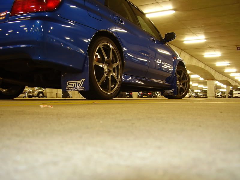

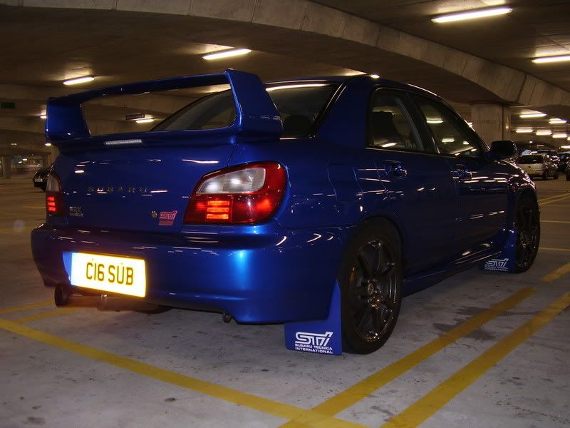

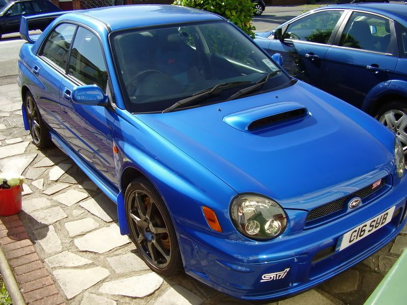

pistonbroke2 Posted July 29, 2008 Posted July 29, 2008 (edited) After seeing Scoobyhoo's car parked next to mine, I've taken his advice and gone out and purchased a Meguiars clay kit. It says on the box that its a quick process, however I'm pretty sure its not going to be. How long should I set aside to get this done? Should I start doing it this evening, or will I be out there until the early hours. I'll be doing some before and after pics to show people what kind of difference to expect. I thought my car was shiny until I saw scoobyhoo's one. I'm hoping for similar (if not better ) results on mine. UPDATE :- finally finished. been down to Bluewater to take some pics in the car park, found that my camera is a bit ****y but you get the impression anyway. First off, you can see the car here pre claying. As you can see, she was no minger to begin with this picture shows her with about 3 coats of recent wax over the past month. I was trying to get the desired look by just polishing and waxing, but to no avail. Then, after claying, you can see the difference with no wax or polish. then, after another wash, three coats of autoglym polish, followed by a coat of gold class meguiars. (these pics do not do it justice. She seems to be a much deeper blue now along with being considerably more reflective, happy days. Edited July 31, 2008 by Pistonbroke2
