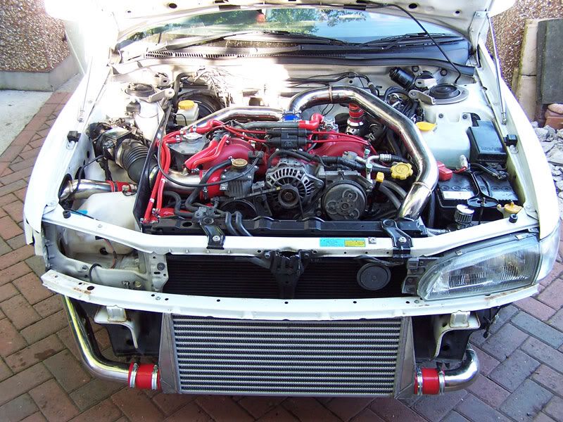

Cret Posted June 19, 2005 Posted June 19, 2005 All looking very nice Dave. Dunno what I will do about a pump - I suppose I really might have to look into buying another from somewhere but pennies are very tight now I'm saving for the wedding so it really narks me that I know it must be around somewhere yet seems to have vanished off the face of the earth. Car isn't going too bad anyway although occasionally it is holding back lower down the revs. You can feel & see on the gauge that it's boosting but the car really holds back then when the revs get higher it seems to go ok again. Seems a bit random too. No idea what's going on there though.
Cret Posted June 19, 2005 Posted June 19, 2005 Have a good trip Andi. Got anyone interested in the leggy yet mate? I'd buy it myself if I had some money.
Cret Posted June 19, 2005 Posted June 19, 2005 Problem solved - found the hose between the charge cooler (heater at the moment!!) and the throttle body was not on right and must have been leaking boost.
