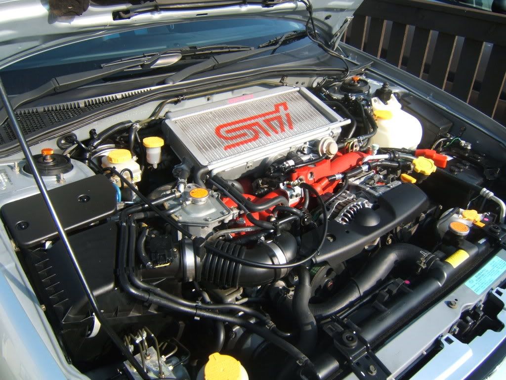

Bugeye29 Posted May 18, 2008 Posted May 18, 2008 (edited) have a look at this guide asit says never use a pressure washer as it drives the water in a garden hose with it set to a heavy mist if u know what a mean will do http://www.polishedbliss.co.uk/acatalog/guides_engine.html anywayz a followed the guide heres how a got on Edited May 18, 2008 by Bugeye29
tommo9375 Posted May 18, 2008 Author Posted May 18, 2008 have a look at this guide asit says never use a pressure washer as it drives the water in a garden hose with it set to a heavy mist if u know what a mean will do http://www.polishedbliss.co.uk/acatalog/guides_engine.html anywayz a followed the guide heres how a got on Looks good mate,what product did you use.Ithink i'll use teh garden hose to be on the safe sied and apply the degreaser with a brush and some elbow grease.
Bugeye29 Posted May 18, 2008 Posted May 18, 2008 Looks good mate,what product did you use.Ithink i'll use teh garden hose to be on the safe sied and apply the degreaser with a brush and some elbow grease. honestly the degreaser does all the work the hose just rinses it off , spray it on and use a paint brush to rub it in , a used to use gunk but it stinks for days a use autoglym engine cleaner doesnt smell much , then spray engine dressing onit to get the shine if u dont do that after cleaning a find u get a white residue

C_WRX Posted May 19, 2008 Posted May 19, 2008 Have a look at my engine bay here mate. Was going to say Colzo did a lovely engine bay clean up a while back...and there he appears. Just no no no to pressure washing, push water where it shouldn't go. Not sure if anyone else has mentioned it but try not have the engine bay facing strong (ocassionally we get that in Scotland!) direct sunlight as you don't want gunk/etc to dry in. Good luck, will look good I'm sure, get the pics up on the finished article.
