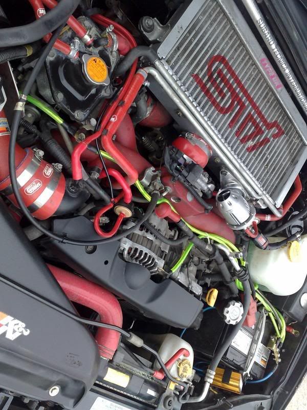

Bugeye29 Posted May 15, 2008 Posted May 15, 2008 hi have a sti 7 uk , and want to fit a boost gauge. need advice on what boost pipe to break in to ? a take it u can only use a pipe coming from the inlet manifold ? also wondered if the white plastic T-piece will be big enough all the hoses look to big ,heres a few pics of my set up
tommo9375 Posted May 15, 2008 Posted May 15, 2008 Hi mate, I recently fitted one to my classic and thought that the hose on the inlet manifold looked alot bigger than the t-piece,but once you pull it off it isn't. The t-piece i used had 2 tapers on each end ,so i pushed the hoses on as far as i could and they've been fine.Good luck with the fitting.:
Bugeye29 Posted May 15, 2008 Author Posted May 15, 2008 Hi mate, I recently fitted one to my classic and thought that the hose on the inlet manifold looked alot bigger than the t-piece,but once you pull it off it isn't. The t-piece i used had 2 tapers on each end ,so i pushed the hoses on as far as i could and they've been fine.Good luck with the fitting.: had a look there but the 2 hoses on the left hand side of the manifold are way 2 big for the plastic t-piece

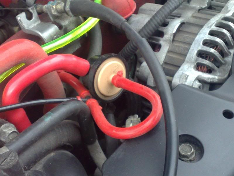

oxbig1 Posted May 16, 2008 Posted May 16, 2008 hi there mate this is what i dun with my 1 i dont know if its wrong or right but it seams 2 work fine
Bugeye29 Posted May 16, 2008 Author Posted May 16, 2008 ad say thats right ma brother had said to fit onto where that valve thing is but the white t-piece a have was to small ,bought a bigger t-piece from halfords so hopefully that works , cheers for the pics much appreiated

mitchel Posted May 16, 2008 Posted May 16, 2008 hi mate i just joined mine at the hose that comes from the standard dv,just cut it and install a t piece,thats how i done it on mine as i had it on the valve the guy above mentioned but i found that it sometimes comes loose from there,and most new ages fit it using the t piece to dump valve,sorry iv no pics mate
Bugeye29 Posted May 16, 2008 Author Posted May 16, 2008 hi mate i just joined mine at the hose that comes from the standard dv,just cut it and install a t piece,thats how i done it on mine as i had it on the valve the guy above mentioned but i found that it sometimes comes loose from there,and most new ages fit it using the t piece to dump valve,sorry iv no pics mate Far as i know taken a feed off any of the inlet manafold pipes is ok just need to find 1 that fits my new t-piece

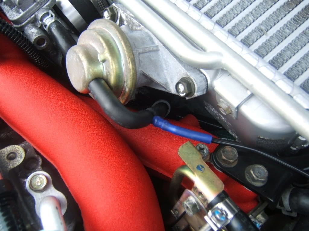

Bugeye29 Posted May 17, 2008 Author Posted May 17, 2008 after worring how a was gonna install it turned out no probs just needed the bigger t-piece from halfords heres some pics , a took the electrical feed off 1 of the wires that illuminates the fog light switches that way it only comes on when ur sidelights are on
