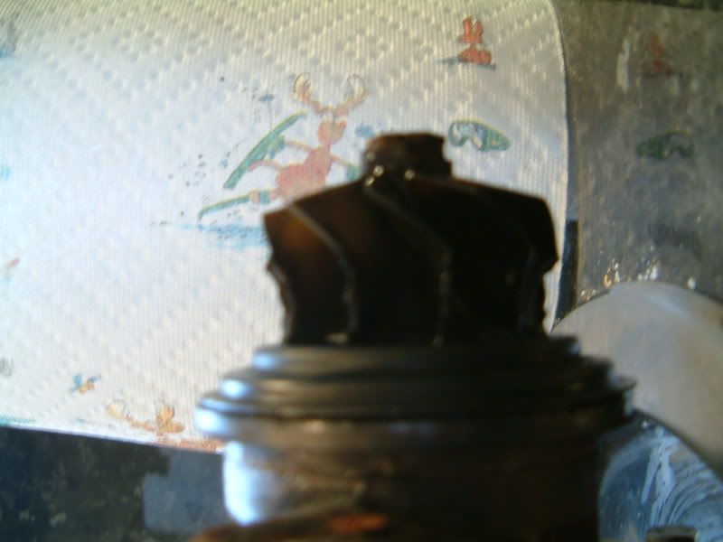

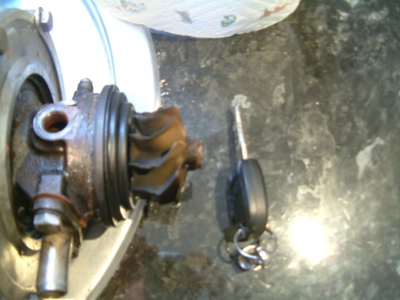

higgy Posted January 6, 2008 Posted January 6, 2008 Well after the car running like a lump of pooooo ( was making 420/430 with the impeler looking like this) i decided to finaly take it to pieces, heres what i found So now it will be getting mounted down stream of the turbo so this doesnt happen again. Higgy

higgy Posted January 6, 2008 Author Posted January 6, 2008 Is it buy a new turbo or just get the inards of that turbo changed I will send it away next week and let them stick a new impeller on it. The new o2 senser was dear enough so im hoping it will be around the £300 mark for a new one instaled and balanced. Higgy
colin_ross Posted January 6, 2008 Posted January 6, 2008 Oh dear. It's never nice when things like that happen but as least it was on the hot side, imagine what that could have done if drawn into the engine. Good excuse to upgrade though.
