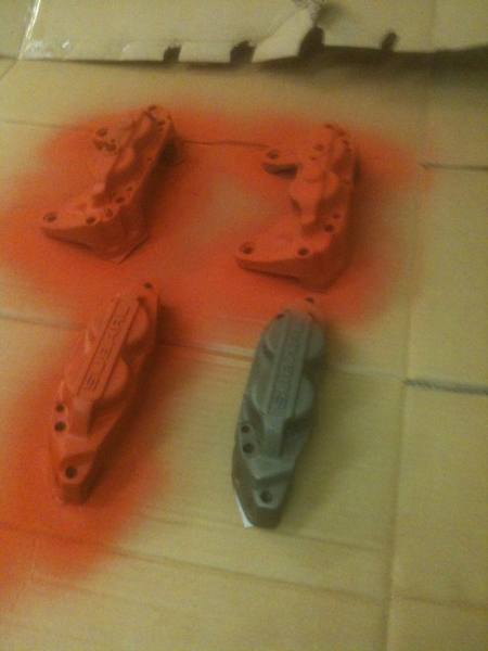

supremeweb Posted April 3, 2010 Author Posted April 3, 2010 Plan for today is to finish painting the underside of the car at the front - second coat the hubs and a few engine parts and now that I have managed to remove the headers, take the up pipe off. Got a reconed pair of 4 pots for the front this week so going to paint them tomorrow and then build them later in the week. Not sure wether to paint them complete or do it in two halfs? Probably decide tomorrow. Hopefully take some pics and get them added too..... Still no joy on the Coilover front..... still looking for a GB.......

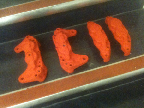

supremeweb Posted April 27, 2010 Author Posted April 27, 2010 Well its been a while since I posted an update, been busy with work and any spare time I have had at home I have used on the car or organising/clearing out the garage. I refurbed the 4 pots I got my hands on and painted them with high temp paint. Had to do this in my office as it was way to cold to do it at home and I did not fancy doing it in the garage where overspreay may settile on my white car! After painting I baked em in the oven for 2 hours at 50 degree's C. I have also taken deliver of a brand new set of BC coilovers, just need to get a adjuster extender kit for the rears as I will be running an interior for now. Few jobs I had not planned on have poped up so will now be changing the wheel bearings due to one loose bearing and 2 very tight bearings. I have also removed the radiator and timing belt cover to change my first ever belt! Wish me luck. After the air con belt snapped it cut a line into the cover and let all sorts of crap in there. Was advised to take the oppertunity to change the belt. No biggie I have been told! Seems my plans of engine work are out of the window now as I really want to get it back on the road for summer. All the time and money I had planned on the engine has gone on upgrading or repairing everything else. This will come in time! You wait till you see what I have planned.
