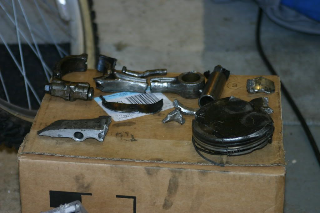

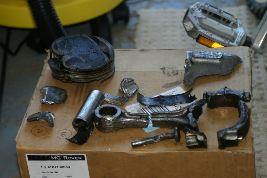

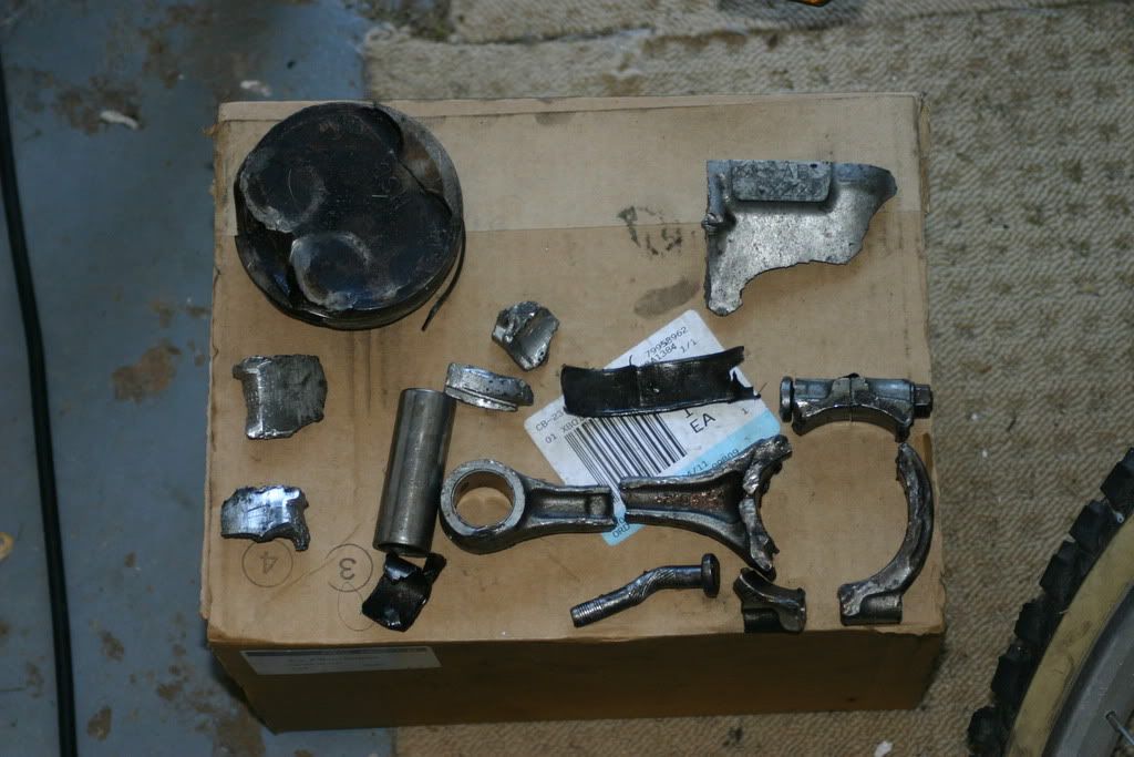

craigdmcd Posted January 20, 2008 Posted January 20, 2008 Sorry, but the piston out of my GT-B took a bit more abuse than that, but then, there was no chance of mine running at the end of this : That is some nice damage to your piston that wouldn't show without careful inspection though. Craig

dipsy Posted January 20, 2008 Posted January 20, 2008 CraiddMcd that looks terrible what did the engine look like after that
craigdmcd Posted January 20, 2008 Posted January 20, 2008 CraiddMcd that looks terrible what did the engine look like after that The alloy triangular section is a chunk from the n/s cylinder block, and 2 valve heads got snapped completely off the stems. As you can guess, the engine was totalled, and could only swap the ancillaries to a new engine. The inexperience of running a JDM on standard UK fuel, a low fuel load, and a giving chase to a Merc at continuous high revs was an expensive learning curve.

thewelsho Posted January 20, 2008 Posted January 20, 2008 The alloy triangular section is a chunk from the n/s cylinder block, and 2 valve heads got snapped completely off the stems. As you can guess, the engine was totalled, and could only swap the ancillaries to a new engine. The inexperience of running a JDM on standard UK fuel, a low fuel load, and a giving chase to a Merc at continuous high revs was an expensive learning curve. Holy crap, what a MESS! I saw an Impreza at Hypertech with lumpbs of engine casing all over the engine bay, was that yours? Dunc did say that the car in question was pursuing a Porsche. Maybe he got his cars mixed up, so, WIY?
craigdmcd Posted January 20, 2008 Posted January 20, 2008 Holy crap, what a MESS! I saw an Impreza at Hypertech with lumpbs of engine casing all over the engine bay, was that yours? Dunc did say that the car in question was pursuing a Porsche. Maybe he got his cars mixed up, so, WIY? No, that was not me, I fitted my engine myself and mine is a Legacy GT-B. The con-rod and the gudgeon pin, I had to retrieve from the bottom of the sump. People ask what broke first, and to be honest I never studied it hard enough to find out, and let's face it - knowing wasn't going to help me rebuild it.
