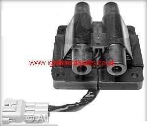

marky.t.s Posted November 2, 2007 Posted November 2, 2007 A bit of technical help required folks,the last 2 days when starting my car the engine sounded as if it was mis-firing when starting up from cold,a very lumpy tickover and a bit of popping.Then after about 5 mins warming up it ticks over as normal.If i try to move of before its warmed up there is very little throttle response,and it picks up and splutters a bit then will not increase in revs at all for a few minutes. On opening the bonnet to check for anything obvious i was treated to a "fireworks "show of sparks dancing around the bolts on the ignition coil thingy.So i nipped over to Hypertech for Dunc to have a butchers,...."it looks like the coil packs goosed" i was informed..."you only get them at a main dealers" So i was wondering if you can get this part from any where else cheaper than the "stealers",would this alone be the cause of my start up probs' as car runs fine after "warm-up". And finally is this the right thing i need??, or is there anything else i would have to get,and is it just the 4 bolts on top and re-fit leads?

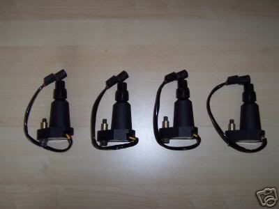

marky.t.s Posted November 2, 2007 Author Posted November 2, 2007 right,now i'm confused ,when i type in"ignition coil pack" on fleabay it shows this below.... which in turn looks nothing like the pic in my first post .........anyone??????

seafar99 Posted November 2, 2007 Posted November 2, 2007 right,now i'm confused ,when i type in"ignition coil pack" on fleabay it shows this below.... which in turn looks nothing like the pic in my first post .........anyone?????? Mark, Different type of coil-packs are dependant on what year your classic is. The later type (which if i remember you have ) will have this type which is situated to the right of the ICV. IMG]http://i38.photobucket.com/albums/e115/seafar99/Engine3-2.jpg There's someone through near Paisley who breaks subaru's, i haven't got his number but it was posted up earlier this week.

marky.t.s Posted November 2, 2007 Author Posted November 2, 2007 the guy who breaks subarus on neilston rd is called stephen,heres his no.07791988191. cheers craig,mine looks the same as your pic,i'll give yer man a call tomorrow.
