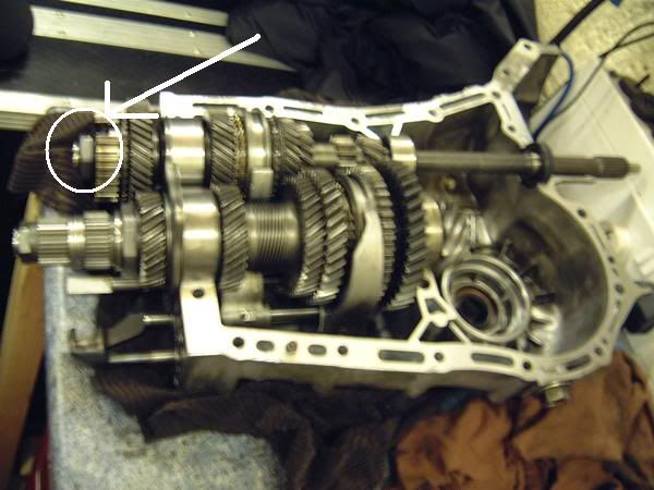

st3ph3n Posted September 25, 2007 Author Posted September 25, 2007 Any idea what sort of price or part number for that Wuz? Another suggestion raised last night was the 5th gear retaining nut coming loose - anyone else heard of this?
st3ph3n Posted September 25, 2007 Author Posted September 25, 2007 The nut in question apparently. Seems to me after doing some reading up that this could be the issue indeed. Anyone know if it really is fixable with the gearbox in the car?
WUZ Posted September 25, 2007 Posted September 25, 2007 (edited) No the easiet job with it on the car m8 - its better if the box is off and then get it stripped apart - figure on £200-210 for stripdown, fit new retaining nut and rebuild with new gaskets. TBH - I though you have more issues than what you are having if this was your problem but.................you never know. Scoob ownership - you gotta love it! Russell Edited September 25, 2007 by WUZ
chris_c201 Posted September 25, 2007 Posted September 25, 2007 Stephen, The 5th gear retaining nut issue was very common on MY99... my STi5 had this issue and the symptoms were that it would slip out of 5th particularly when the car was warm. It was quite obvious though as if i was in 5th and gently accelerated then lifted off i could clearly see about 2 inches of travel on the gearstick. Also used to have to double clutch regularly for reverse and sometimes after reversing it was really difficult to get back to neutral. It is apparently possible to fix this issue with the box on the car (for a MY99 anyway) as the rear cover on the box comes off and allows access, in the end though i put mine in for a full rebuild as i was concerned that due to the age / mileage there may be some other gremlins in there. Maybe not much help but as i say it was very obvious that 5th gear was moving in my car due to the gearstick... HTH Chris

drb5 Posted September 25, 2007 Posted September 25, 2007 Your definately not experienceing the usual 5th gear nut coming loose, IMHO Stephen. As said before, i'd be for checking the linkage first before anything else.
