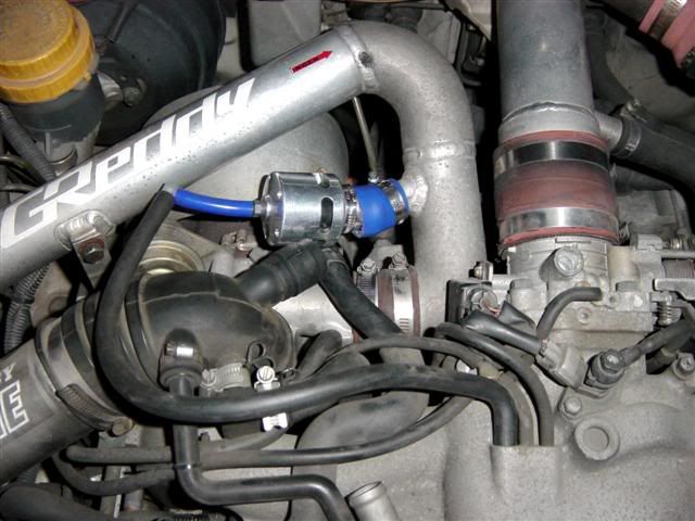

rabskyline Posted July 24, 2006 Author Posted July 24, 2006 es boys! i can yap !!! as for the dump valve , i think i havent done it properly as it drives like a plug now and the check engine light came on !lol ! can someone tell me if its fitted correctly ! it sounds great revved on the drive but when i drive it there is no power. the car is very low on fuel though too !i'll post pics ! i think it possibly fuel now that i think of it but have a look at the pic !
col666 Posted July 24, 2006 Posted July 24, 2006 Looks like hose clip has come off samco at valve end!
bigdavie Posted July 24, 2006 Posted July 24, 2006 have a look there rab looks like a dodgy seal mate ! hth !
johnnyr6 Posted July 24, 2006 Posted July 24, 2006 thats not a recirc, its a vta... if running standard ecu be careful, smell fuel, remove borewash is likely
bigdavie Posted July 24, 2006 Posted July 24, 2006 also that looks like it should have a hose or something attached ... no ??
rabskyline Posted July 24, 2006 Author Posted July 24, 2006 no this pipe was like this when i got it ! i think it was something that isnt needed now since the fmic was fitted ! but col, the hose clip isnt on right as the hose needs a 90 deg bend to suit its position. its ok when idling but the power is down when driving along the road but there is practicaly no fuel in her and the check engine light came on. could this be down to low fuel pressure since its nearly empty ?
bigdavie Posted July 24, 2006 Posted July 24, 2006 doubt its the low fuel i ran mine dry when changing the fuel filter !! unintentional btw !! but i did not get a cel put the re circ back on and see what its like when you refuel ??
Rossco_ Posted July 24, 2006 Posted July 24, 2006 have a look there rab looks like a dodgy seal mate ! hth ! Man that IS your issue, you have an insanely huge boost leak caused by the short samco hose that attaches to it not being attached properly, no pressure = no notes, dont know enough about the cars yet to advise on the CEL but it might have something do with lack of boost pressure
rabskyline Posted July 24, 2006 Author Posted July 24, 2006 ye know i think you are right ! the pipe isnt right and it does need a 990 deg pipe to make good. this might also cause the cel as it wasnt doing it b4. but i cant run it about too much as there is no tax mot yet ! .

rabskyline Posted July 24, 2006 Author Posted July 24, 2006 the valve is coming off ! i am not getting full boost and the cel is on. bugger ! it sounds great too. maybe i havent fitted it properly , ie, on the right part of the intercooler pipes etc. i put a new elbow on it today and checked it all over but not boosting well. it was in direct replacement of the recirculating on aswell ? any you guys got a fmic with a vta bov fitted ?
Edinburgh-Chris Posted July 24, 2006 Posted July 24, 2006 A picture of mine mate. You have a crap connection. When it comes to a front mount/ BOV all connectinos need to be sealed well or the internal pressure will expose this at all times. Ie. Crap boost and most likely a CEL on display.
rabskyline Posted July 24, 2006 Author Posted July 24, 2006 i have mine on the left hand pipe ! could this be a factor ? i have fitted a new elbow to the bov and is tight and snug.
