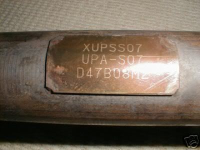

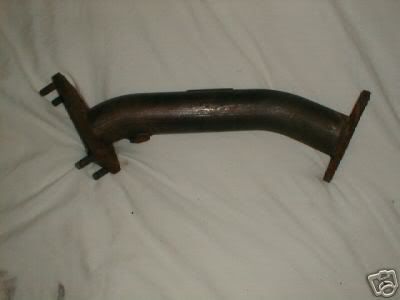

chris_c201 Posted March 4, 2006 Posted March 4, 2006 Not trying to steal Gus' thunder.... Do you think this up-pipe will fit my bugeye WRX...... Currently standard although planning on this and a de-cat downpipe (not bought yet) Cheers Chris
des_curran Posted March 4, 2006 Posted March 4, 2006 That part no.(xupsso7) is listed for 2002 on sti, the other magnex up-pipe is listed for wrx/sti 2001 on(xupss05) i think the only difference is a lambda boss and a slip joint !
des_curran Posted March 4, 2006 Posted March 4, 2006 I'm not really sure to be honest m8, but the other part no. fits both models so it might just need a bung in the lambda boss !
~ ~ Cal ~~ Posted March 4, 2006 Posted March 4, 2006 The upipes on classics and bugeyes are the same size. You can get a CEl fix if it doesn't have the boss So it should fit your car CGS
WUZ Posted March 7, 2006 Posted March 7, 2006 ARGH! - how many times do I have to say this.............. IT IS NOT A LAMBDA BOSS, IT IS AN EGT BOSS WHICH ONLY THE WRX'S REQUIRE AS THEY HAVE AN UPPIPE WITH A CAT IN IT!!!!!!!!!!!!!!!!!!!!!!![:@] Rant over now. All is calm again! Russell ps - it will fit but you'll need to wrap that uppipe first. I would recommend a flexible uppipe or one with a slip joint in it before this one to be honest.
chris_c201 Posted March 7, 2006 Author Posted March 7, 2006 ARGH! - how many times do I have to say this.............. IT IS NOT A LAMBDA BOSS, IT IS AN EGT BOSS WHICH ONLY THE WRX'S REQUIRE AS THEY HAVE AN UPPIPE WITH A CAT IN IT!!!!!!!!!!!!!!!!!!!!!!![:@] Rant over now. All is calm again! Russell ps - it will fit but you'll need to wrap that uppipe first. I would recommend a flexible uppipe or one with a slip joint in it before this one to be honest. Lol, easy tiger! It sold anyway, i will prolly hold out for a flexi one..... Cheers Chris
