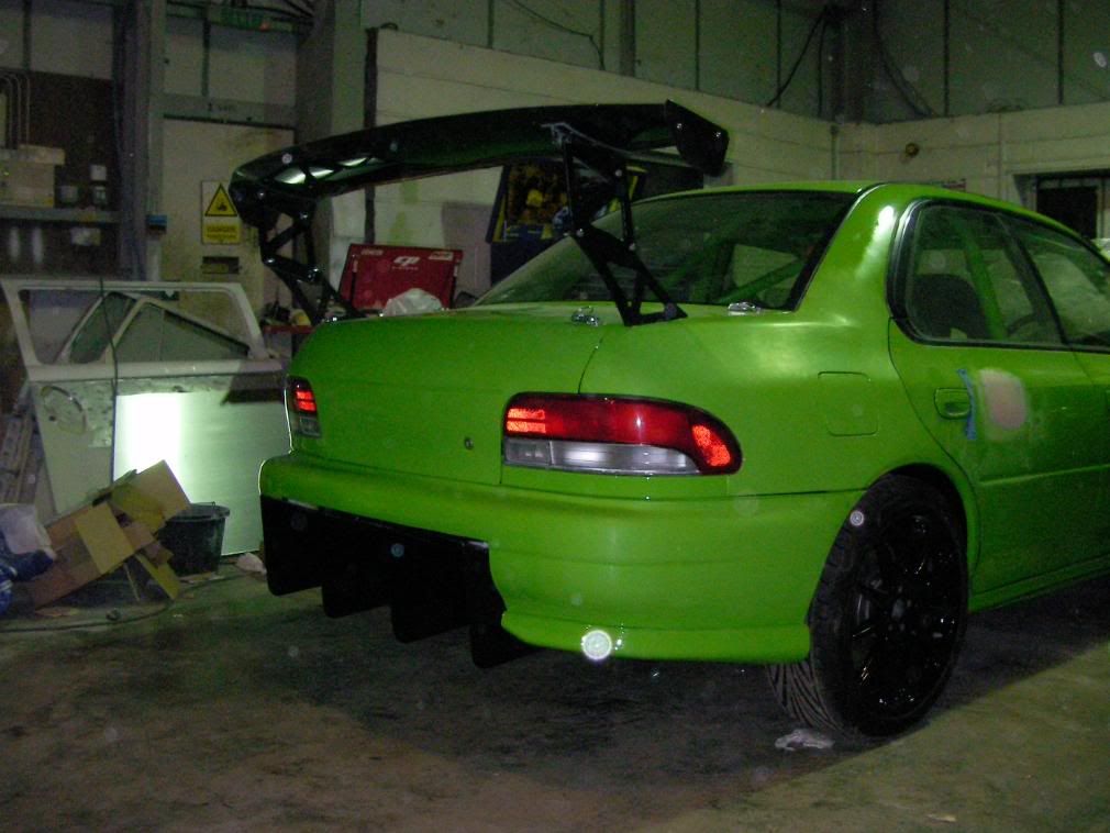

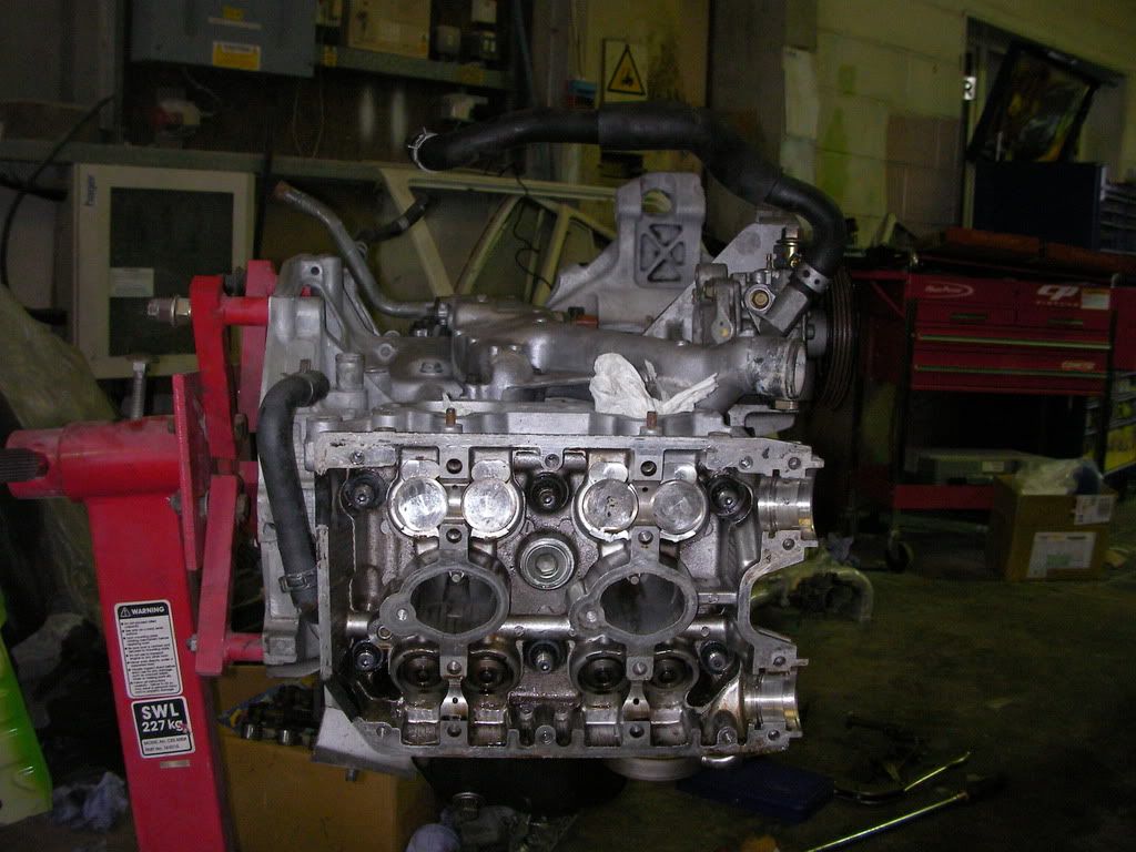

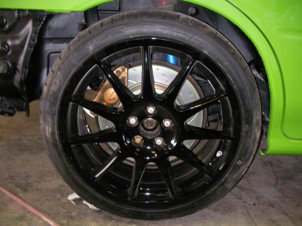

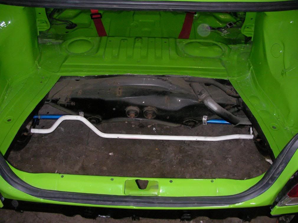

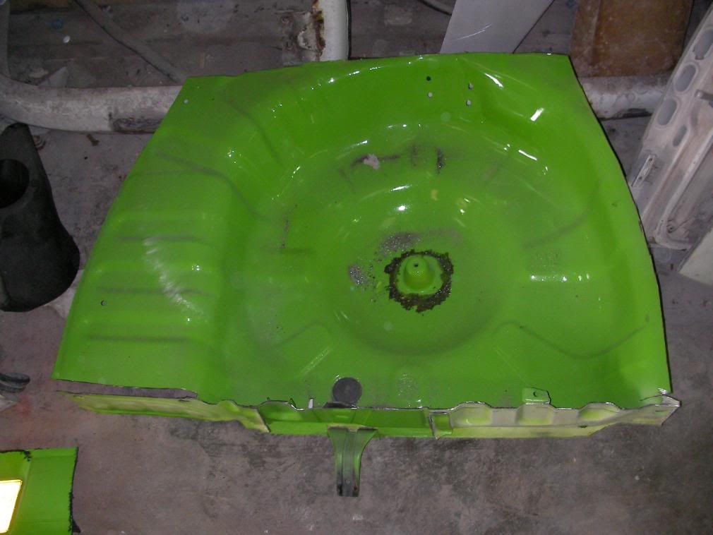

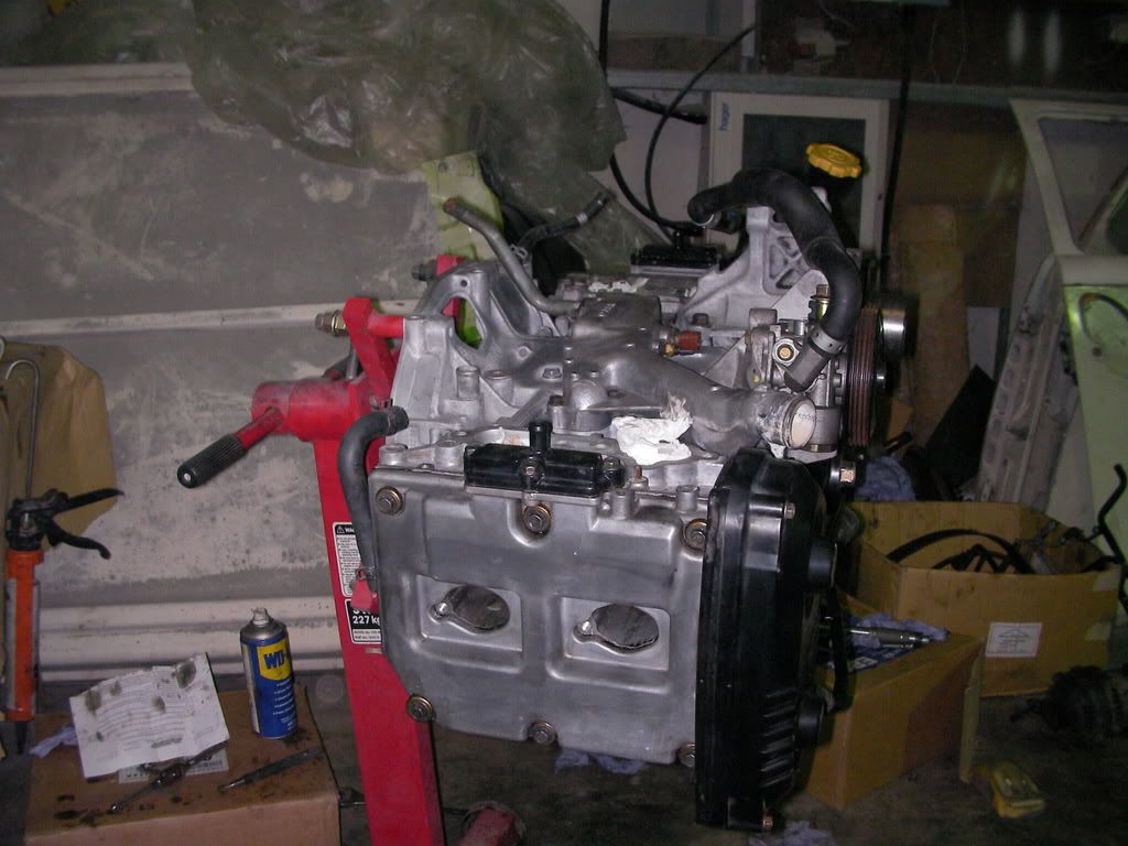

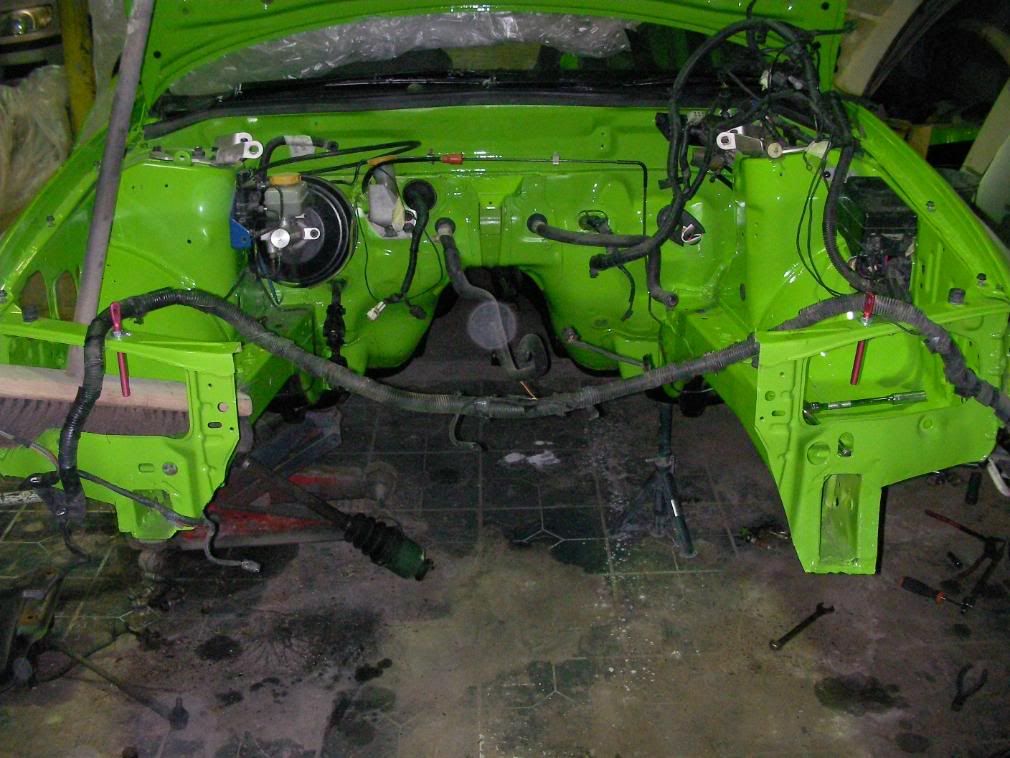

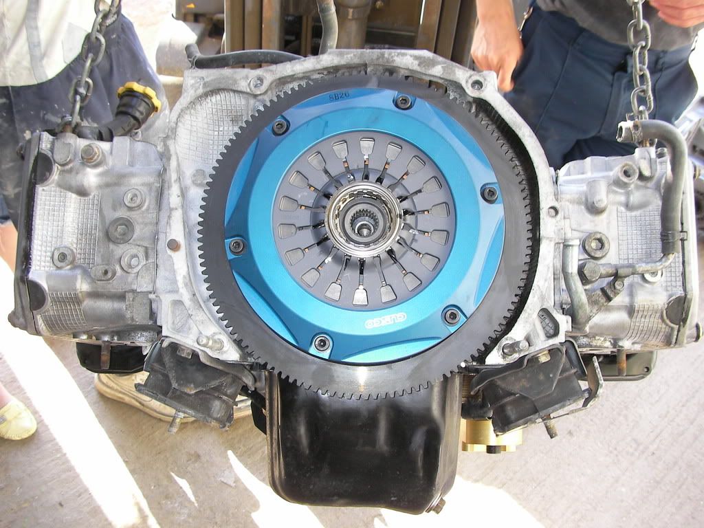

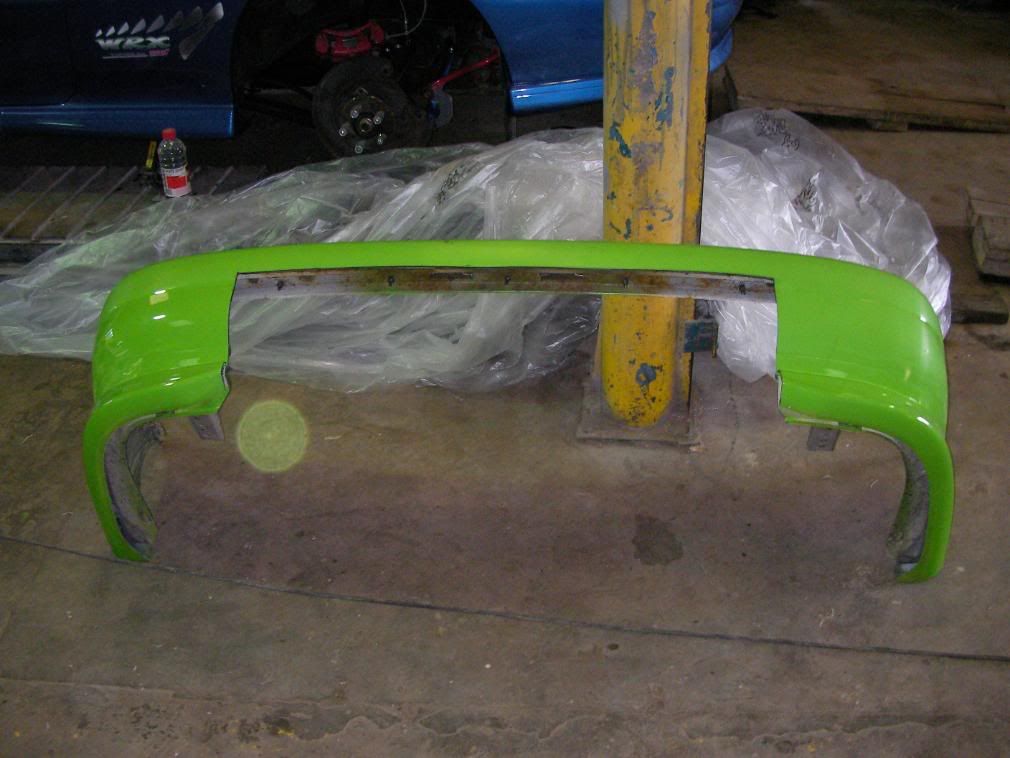

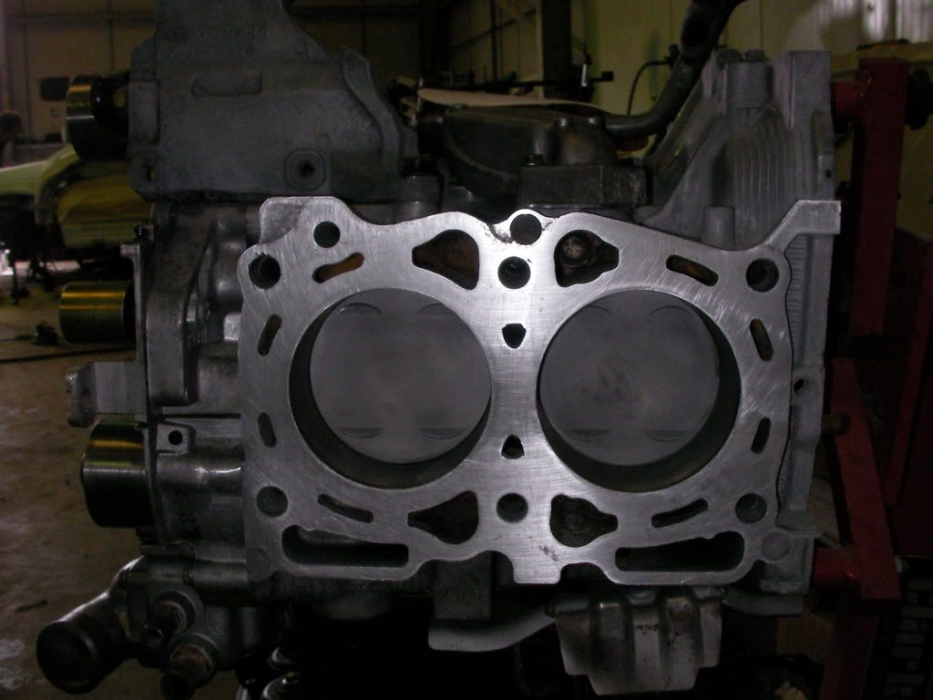

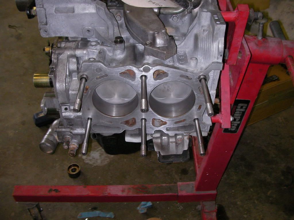

richtypera Posted June 7, 2008 Author Posted June 7, 2008 havent been on here in a while been doing alot of little gobs. ill just post pics instead of writing an essay sorry no picks of the block building but i didnt have my camera. engine spec closed deck block v4 sti crank h beam rods acl race main and rod bearings arp rod bolts omega pistons 1.3mm cometic gaskets arp head studs v4 sti heads i had a bit of time while i was waiting for my twin plate clutch (still not arrived yet) so got on to the rear defuser coped all the floor out rear chassi and bumper to allow for the new defuser. i orderd a sheet of 8 by 4 2mm thick ally. to make it myself. useing a good freinds gilatine and bender.ex.. while waiting for that to be deliverd i got the rear trailing arms fitted and the whiteline also the new age hubs and rear brembos.

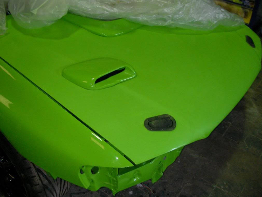

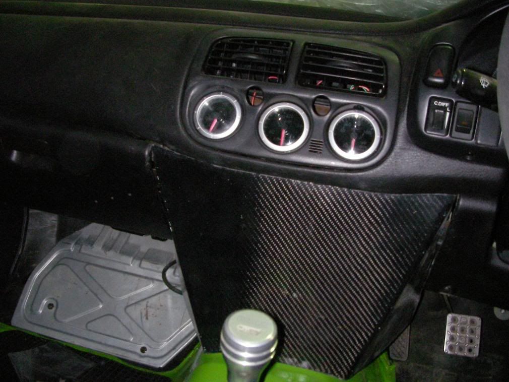

richtypera Posted June 7, 2008 Author Posted June 7, 2008 also raised the spoiler another 7" for the best air flow few other little bits guages and aero catches fitted the wider front axle to match the back off the new sti. the main tool in the box. brush to hold the bonnet up

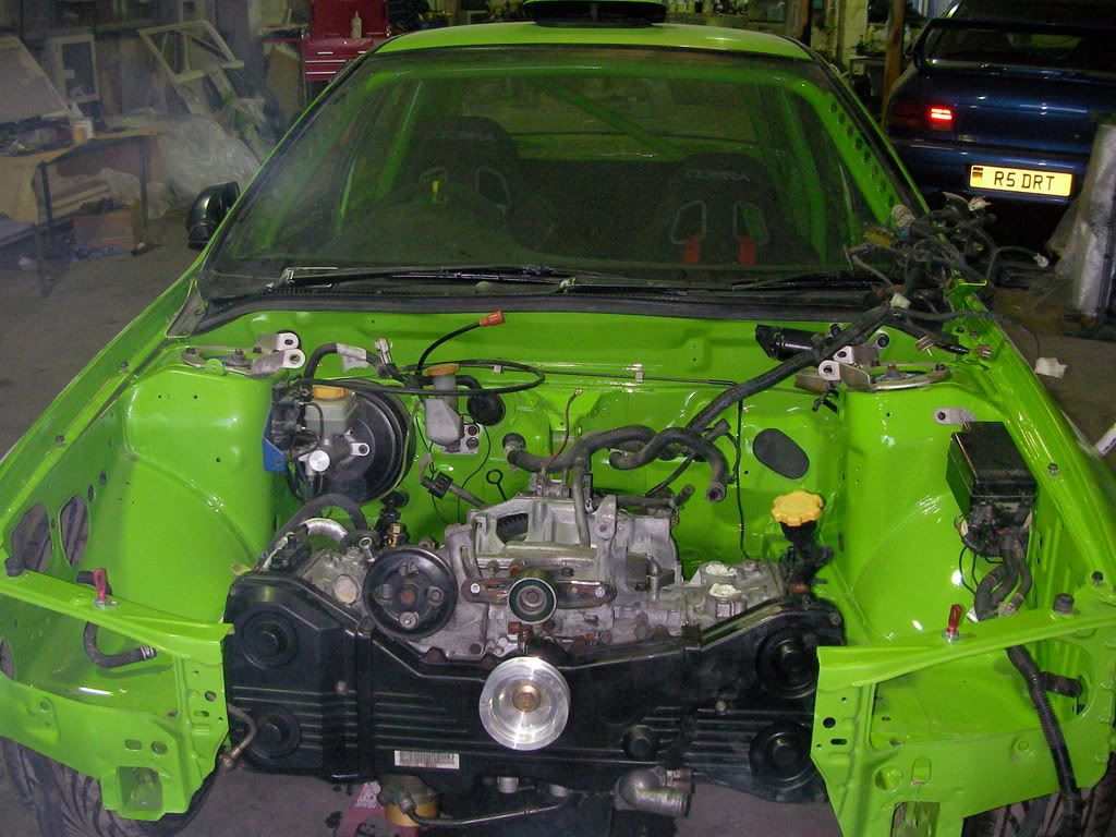

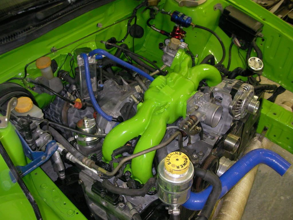

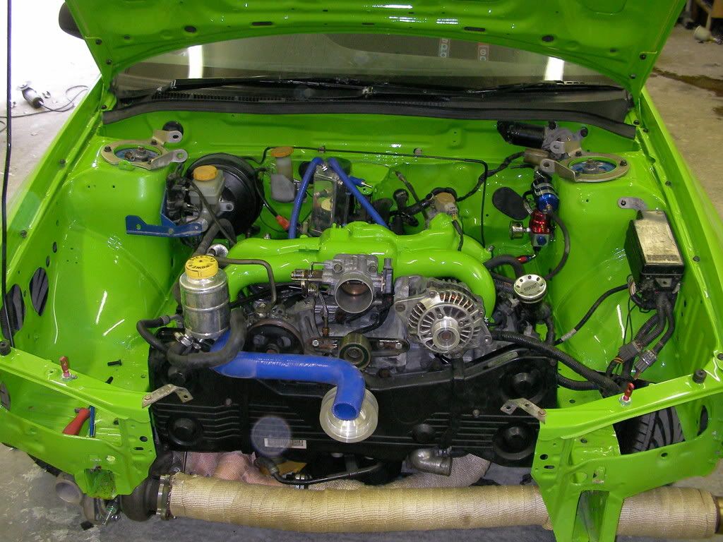

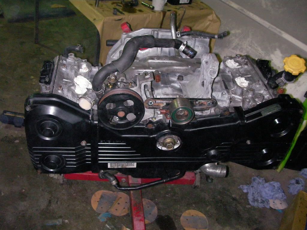

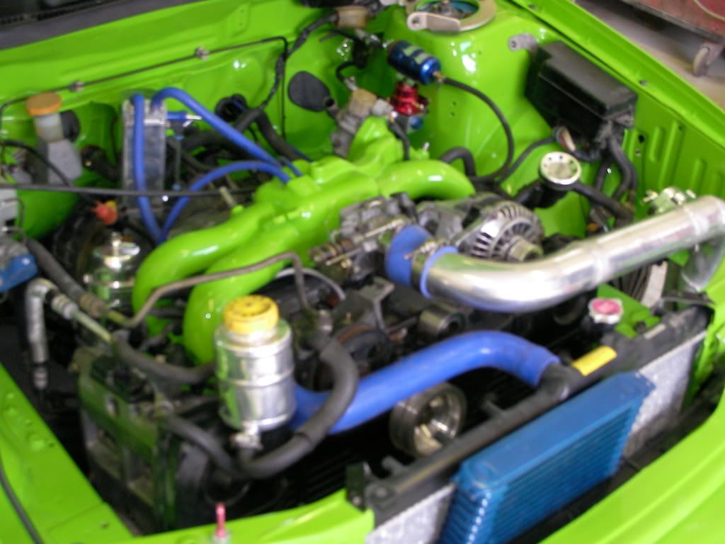

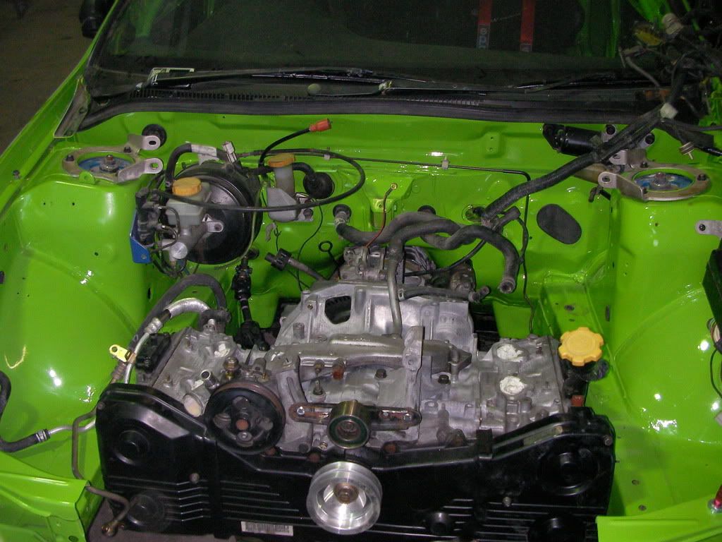

richtypera Posted June 28, 2008 Author Posted June 28, 2008 couple of update pics of the engine going in.

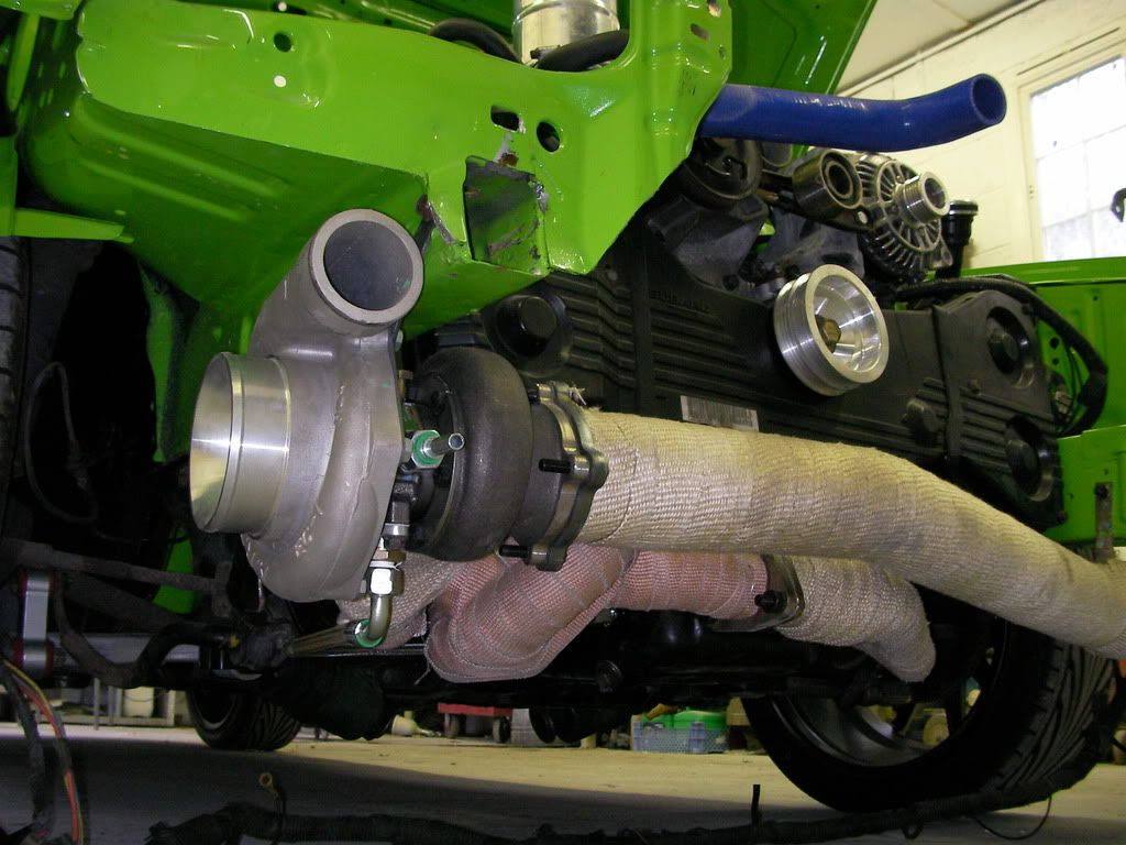

richtypera Posted July 11, 2008 Author Posted July 11, 2008 a few pics to update my progress. spent most of my time doing little bits that take a while.
