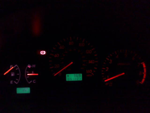

scouk Posted November 29, 2007 Posted November 29, 2007 Thanks for that i dont suppose you know how many i would need Also do you just have to remove the 2 screws from the top of the Dials to remove them????? I tried changing the colour on my Bug WRX.. But it's not quite as simple as changing the colour of the bulb.. The plastic channels that the light passes through to light up the dials is actually green too.. So putting in a plain white bulb just shows green! Which sucks! What i've done for the moment is put in some red LED's which does override the green colour but it's quite a dull dashboard.. Still readable when dark but I'd much rather it was brighter.... Also the LCD displays still stay green they dont work too well with the red LED's end up with a red sunspot effect in the middle of the LCD and fading out to green. I did read a mod on the net somwhere where someoen took their dash apart and scrapped off all the green filtering stuff somehow to make it work.. If I could get my hands on a spare set of dials I'll give it a go. just don't want to do it on the current one... Failing that try and source a red dialled dashboard... I've been hunting for one for months, especially a blobeye one with the rev coutner in the middle! but no joy

scouk Posted November 30, 2007 Posted November 30, 2007 Ah thats not sounding to hopfull al keep an eye out for a set of dials i wonder if the ones of a hawk eye sti would fit ?? I believe they fit yeah but I heard that the wiring is slightly different somehow.. not majorly easy to adjust Somethign about the clock being wired into it or something. The hawkeye STi' ones woudl rock.. Defi startup routin *drool* For the sake of interest here's a photo of my dash this morning: The needles light up nicely but as you can see round the top of the dial it's dull.. In fairness it's slighter easier to see in real life than in that photo Also that pinkness near thje fuel gauge isn't pink it's red like the rest of the dials.. dodgy photo..
