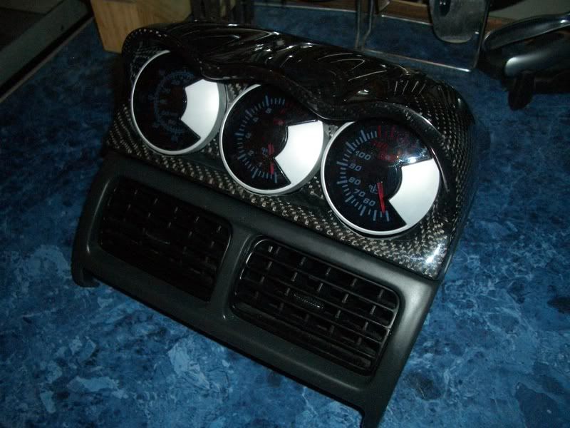

prodrive tony Posted June 13, 2007 Posted June 13, 2007 Had to cut holes bigger....pis*sed me off!!! Not as neat as I ant. Cheers for help Trev. [Y] Havent touched the wires yet!!
prodrive tony Posted June 13, 2007 Author Posted June 13, 2007 [Y] By the way there not fixed at the mo hence big gap!!!!
monkip1 Posted June 13, 2007 Posted June 13, 2007 That looks the dogs mate! Defi's definatly look the part there. Monki.
prodrive tony Posted June 13, 2007 Author Posted June 13, 2007 [Y] Not defi's though mate. anyone know the best place to put oil pressure sender??
dazzlers82 Posted June 13, 2007 Posted June 13, 2007 in were the original oil pressure sender is you can get a braided adapter so can fit gauge sender an original in there an if got oil temp fit that above cylinder 3[Y]
prodrive tony Posted June 13, 2007 Author Posted June 13, 2007 Where can I find original oil pressure sender and is cylinder no 3 on the right and nearest the rear if viewed from front of car?? Thanks matey.
dazzlers82 Posted June 13, 2007 Posted June 13, 2007 cylinder 3 is below the turbo mate an the oil presuure sender is under the alternator there is an allen key bung under the turbo fit the temp sender in there[Y]
