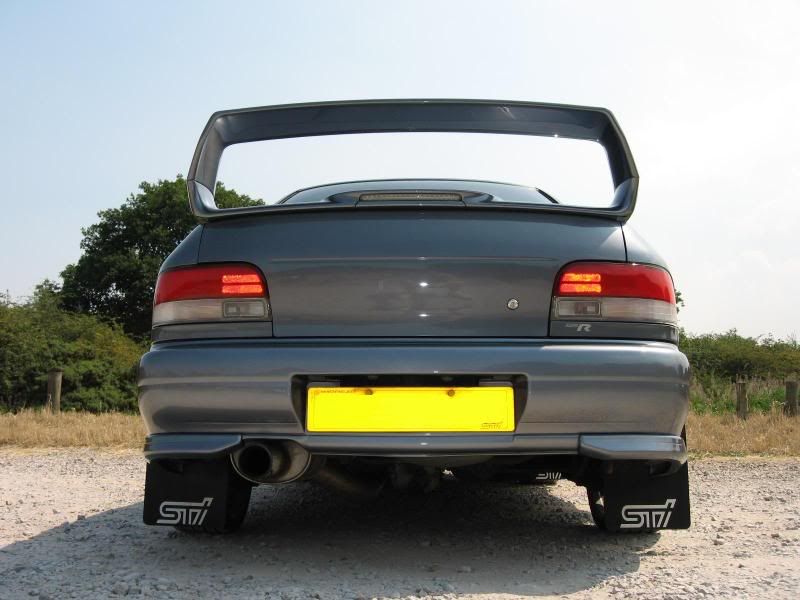

prodrive tony Posted November 12, 2006 Author Posted November 12, 2006 Might sort out a group buy if we get around 10???
Dalthegooner Posted November 12, 2006 Posted November 12, 2006 Im tempted to go for some mud flaps but unsure?? Whats the score like/dislike?? Heres a couple of pics of my flaps [][]
Nudge Posted November 13, 2006 Posted November 13, 2006 Yea i quite loike flaps.....[:$] I fitted a set on mine last week, give's them that rally look.. [Y]

prodrive tony Posted November 21, 2006 Author Posted November 21, 2006 Monty......You really are a god!!! Thanks mate doing it Thursday. Sweet motor Dal.
