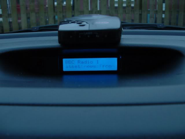

ed-209 Posted March 10, 2006 Posted March 10, 2006 I was talking about this on Sat, about replacing the digital clock with a DAB radio adaptor. sound reception is really good when not moving, but I will need to get a better antenna. connected it via a rf modulator as a stop gap, will get rewire direct to the aux ports in the boot when doing the boot build. So that another part of the project done. Ed.
wrxmania Posted March 10, 2006 Posted March 10, 2006 Looks superb - have you done it yet - and how? Where are you going to fit your Defi BF's you MUST get now? Brian []
ed-209 Posted March 10, 2006 Author Posted March 10, 2006 Yep I did it last night for fixing the pod to accept the digital display and today for wiring up the phono to rf mod and the power, I used a small dab adaptor that currys where selling off at £19.99 the digital display is only about 2mm short for the clock hole (thank god for hot glue guns). not really as hard as I would have thought.the hardest part was getting the guts to cut the back of the pod,as for the Defi gauges I will use A piller pods (I hope) Ed
dieselpower Posted March 11, 2006 Posted March 11, 2006 That's fantastic!! Might try the same thing. Will save splashing out £200 on a Revo! Cheers
