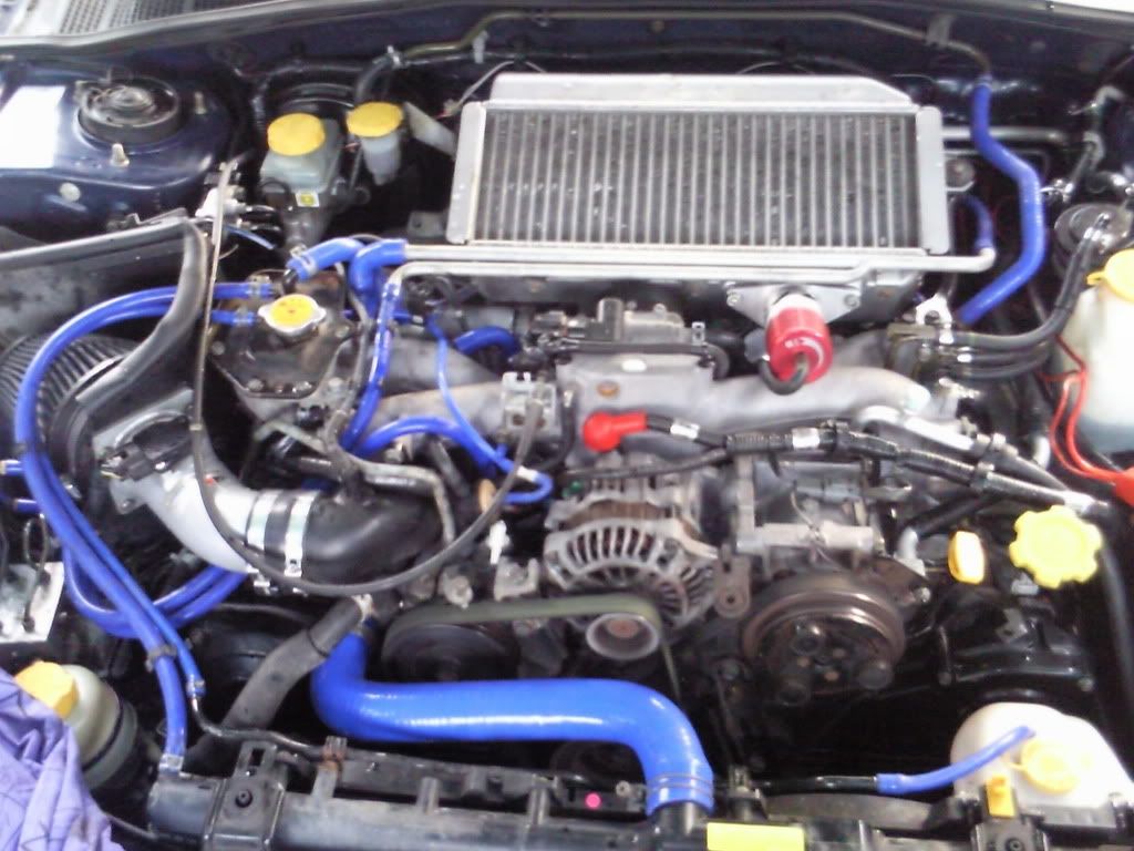

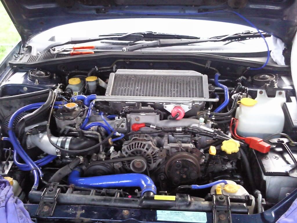

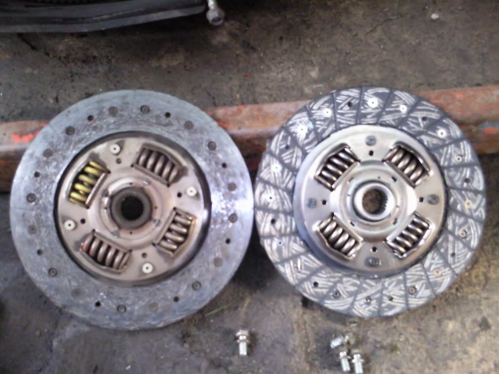

swifty1981 Posted March 6, 2009 Posted March 6, 2009 took the week off of work to fit my clutch and get some new blue hose's fitted (cheers col) the old clutch was well worn lol
granby Posted March 6, 2009 Posted March 6, 2009 That blue hose on the N/S of the car by the intercooler, did you take the oneway valve out of the old one and put it in that hose, if you didn't you may find the brakes are not very good
Scooby Hoo? Posted March 6, 2009 Posted March 6, 2009 That blue hose on the N/S of the car by the intercooler, did you take the oneway valve out of the old one and put it in that hose, if you didn't you may find the brakes are not very good Lets hope so Granby
swifty1981 Posted March 6, 2009 Author Posted March 6, 2009 lol yeah i took it back off, i found out after going down the road that all my boost was coming out the brake servo lol

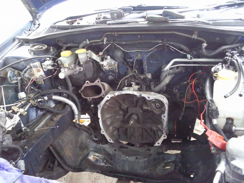

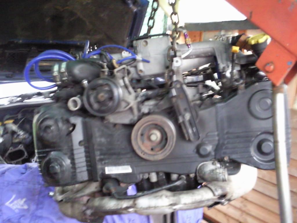

yogi- Posted March 6, 2009 Posted March 6, 2009 He only went out to polish the chrome in the engine bay, and took the engine out instead
kentperformance Posted March 6, 2009 Posted March 6, 2009 Blimey, That's a bit drastic taking the engine out to do the clutch!
Scooby Hoo? Posted March 6, 2009 Posted March 6, 2009 lol yeah i took it back off, i found out after going down the road that all my boost was coming out the brake servo lol No Boost but Boy WHAT BRAKES
swifty1981 Posted March 7, 2009 Author Posted March 7, 2009 i took engine out because i wanted to clean engine bay and was going to polish the manifold but i started running out of time. did the plugs at the same time
Scooby Hoo? Posted March 7, 2009 Posted March 7, 2009 did the plugs at the same time Injectors, turbo, headers and up-pipe? Well done Ad, all under a tarpaulin
