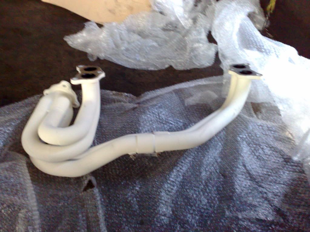

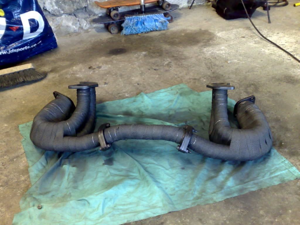

craigdmcd Posted January 13, 2009 Posted January 13, 2009 (edited) Chris, so you can see the difference, here are my GT-B headers, very carefully wrapped and painted and my new RCM headers coated by Zircotec sorry for the slightly hazy pics, but a 5 megapixel phone just doesn't match up to a 35mm DSLR Edited January 13, 2009 by craigdmcd
ciaranrb5 Posted January 13, 2009 Posted January 13, 2009 Chris, so you can see the difference, here are my GT-B headers, very carefully wrapped and painted and my new RCM headers coated by Zircotec sorry for the slightly hazy pics, but a 5 megapixel phone just doesn't match up to a 35mm DSLR They look brilliant Zircotec coated but it's just to bloody expensive and i would chip them installing them!! Can you wrap on top of that coating for double insulation?
craigdmcd Posted January 13, 2009 Posted January 13, 2009 They look brilliant Zircotec coated but it's just to bloody expensive and i would chip them installing them!! Can you wrap on top of that coating for double insulation? I was down at the Autosport show, and was talking to the boys on the Zircotec stand, when they showed me an exhaust from a racing bike that had gone down on it's side. The exhaust was worn through where it had scrapped along the tarmac, but had not chipped of flaked, even where it had taken a bend. It was very impressive indeed, and made me very happy about going down this route. I would have liked one of the new colours available, but it was an extra £70, and I was already overbudget on them. I think you could heatwrap again, but I was lucky I didn't as I have very little clearance to the front crossmember, and the wrap might have chaffed away. I am very happy with them now, with the car feeling faster, although that is more down to my pockets being considerably lighter .
