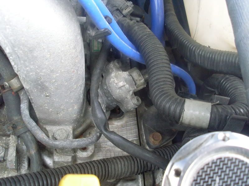

emoe Posted October 6, 2008 Posted October 6, 2008 Depends on what engine you have. The 98 was right on the cusp of Phase 1.5 and Phase 2 engines. If your COIL PACK is in the middle of the intake manifold, and the AIR CONTROL VALVE is a hunky thing on the right hand side, then its a Phase 1.5 If the COIL PACK is on the right hand side and the AIC valve is smaller, then you have a phase 2 Bear in mind, thats a visual check on a STANDARD CAR, if someone has messed about and fitted a later intake or such like then youll not know for certain, youll then need to look at the fuel rails. Phases do use different fitments for injectors. Try taking a pic of the engine and injectors with fuel rail and we may be able to give you an idea. Good luck.
prodrive tony Posted October 6, 2008 Author Posted October 6, 2008 Depends on what engine you have.The 98 was right on the cusp of Phase 1.5 and Phase 2 engines. If your COIL PACK is in the middle of the intake manifold, and the AIR CONTROL VALVE is a hunky thing on the right hand side, then its a Phase 1.5 If the COIL PACK is on the right hand side and the AIC valve is smaller, then you have a phase 2 Bear in mind, thats a visual check on a STANDARD CAR, if someone has messed about and fitted a later intake or such like then youll not know for certain, youll then need to look at the fuel rails. Phases do use different fitments for injectors. Try taking a pic of the engine and injectors with fuel rail and we may be able to give you an idea. Good luck. ok thanks Ill get a picture, I do have coil pack in middle.
emoe Posted October 6, 2008 Posted October 6, 2008 ok thanks Ill get a picture, I do have coil pack in middle. Ok that sounds like a Phase 1.5 engine, so youll need Phase 1.5 injectors or Phase 2 with the adapters.
