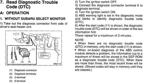

Linky Posted August 9, 2008 Posted August 9, 2008 (edited) I use Delta dash to read all my codes and log through my OBD plug...... But you can use the diagnositc connectors under the drivers side of your dash board. If the car is in safe mode you will only get minimum boost (should be around 0.5bar ish providing you have standard waste gate) and i believe you should have a CEL light up also. The car will usually run rich in safe mode as the ecu can add 25% more fuel. The oil issue would not bring up your CEL light and the smell of oil is not a sensor issue. How much oil is the car using? If your still stuck at the end of the month , I'll be in Glasgow at the end of the month and can run my DD on your car if you wish..... I hope this helps Colin Oh the usual if anything goes wrong it aint my fault applies Edited August 9, 2008 by Linky
pmacFTO Posted August 9, 2008 Author Posted August 9, 2008 aha...I wondered if there was a way to get the codes without the OBD2 - my old FTO was the same - just had to eart out one pin on the plug and the dash lights would flash! Does this method work on newage cars? I thought I had read somewhere that only classics had this diagnostic method.
