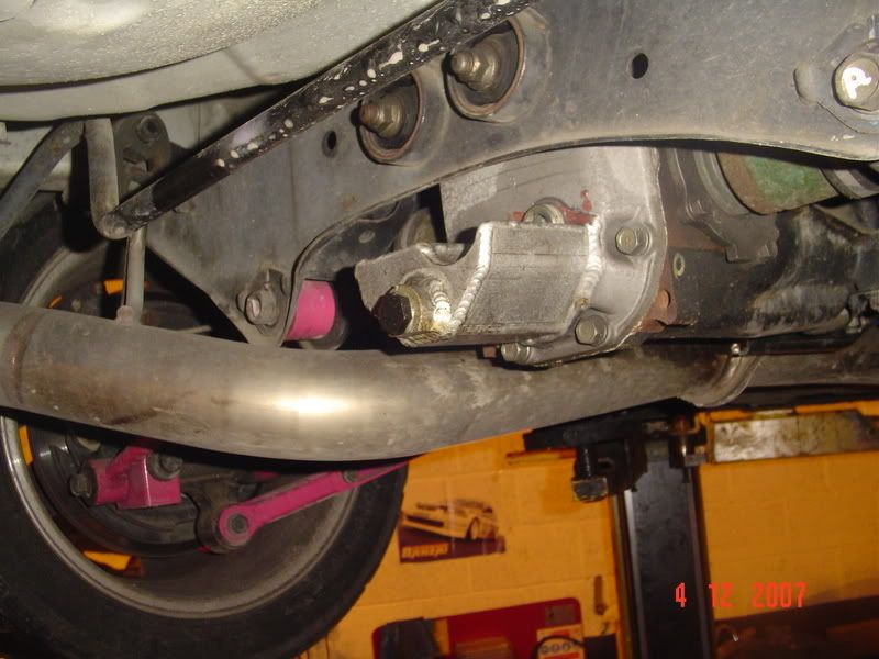

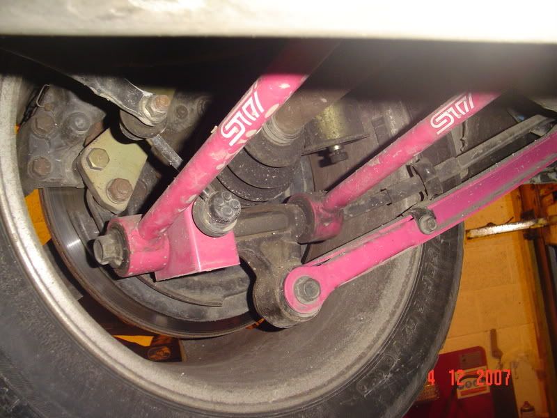

deani_age Posted January 31, 2008 Posted January 31, 2008 ...and what their function is? The pink parts with STI on them Thanks for your help Dean
dazzlers82 Posted January 31, 2008 Posted January 31, 2008 (edited) there called control arms an the rear arm is what sets you toe angle (nt sure if same on classic ) by an eccentric bolt hope that helps also you will probably find if there not fitted the the axle will move from side to side Edited January 31, 2008 by dazzlers82
mean greenie Posted January 31, 2008 Posted January 31, 2008 they are your rear lateral links, as dazzler said, allows adjustment to camber angle, probably stiffer than standard links. tsl sell perrin items, the same sort of thing.
